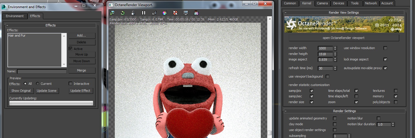

You can see that for some reason the same scene is taking over 1GB more in octane 2. Now, I thought this might be due to some of my hidden layers still having hair and fur modifiers on them (even though they are disabled in the stack). So I removed everything in the scene but a single mesh and re-saved the file. To be clear this scene contains just a mesh and a light - no modifiers.

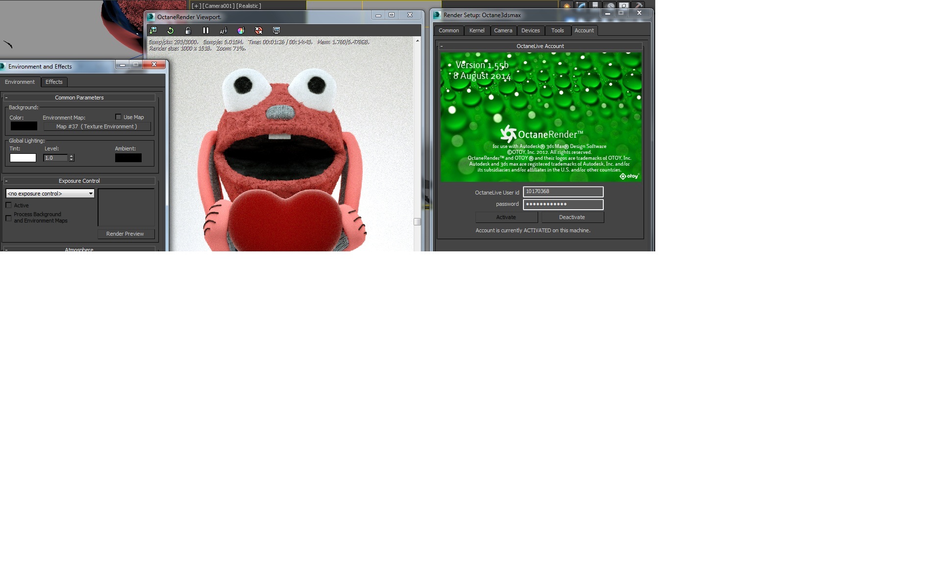

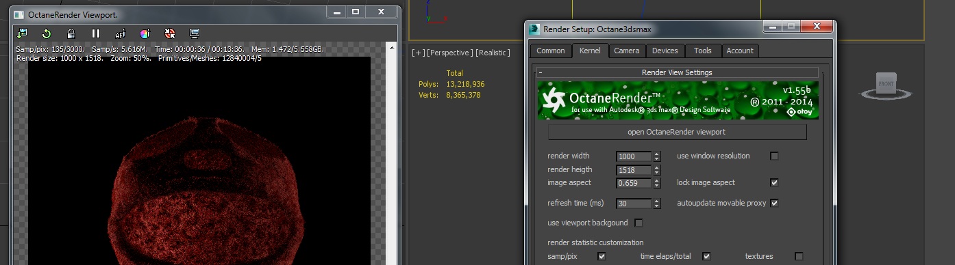

This is the scene opened in 1.55

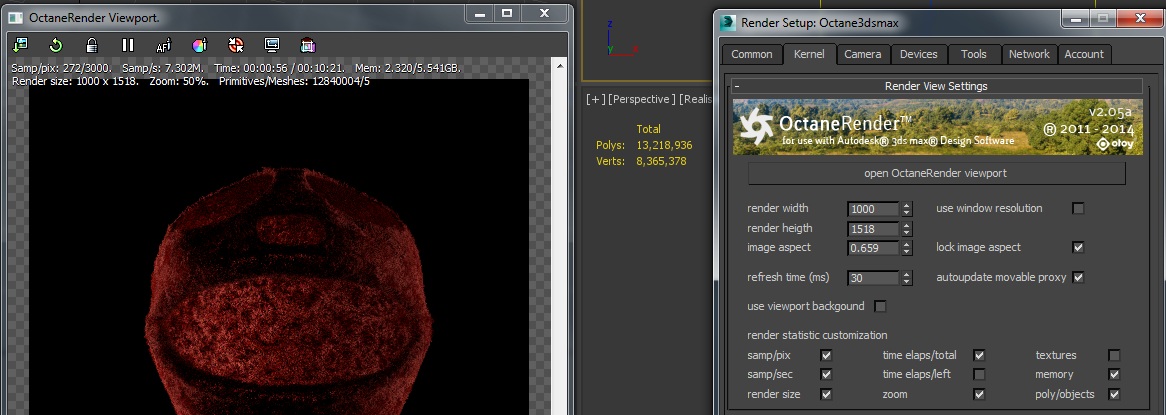

This is exactly the same scene in 205 :
As you can see in Octane 1.55 the scene takes up 1.4GB and in Octane 2.05 it takes up 2.3GB
This is the same max file simply rendered with the two versions of octane. Since version 2 has been released I cannot open the full file of this character without running out of RAM and octane failing every time.
