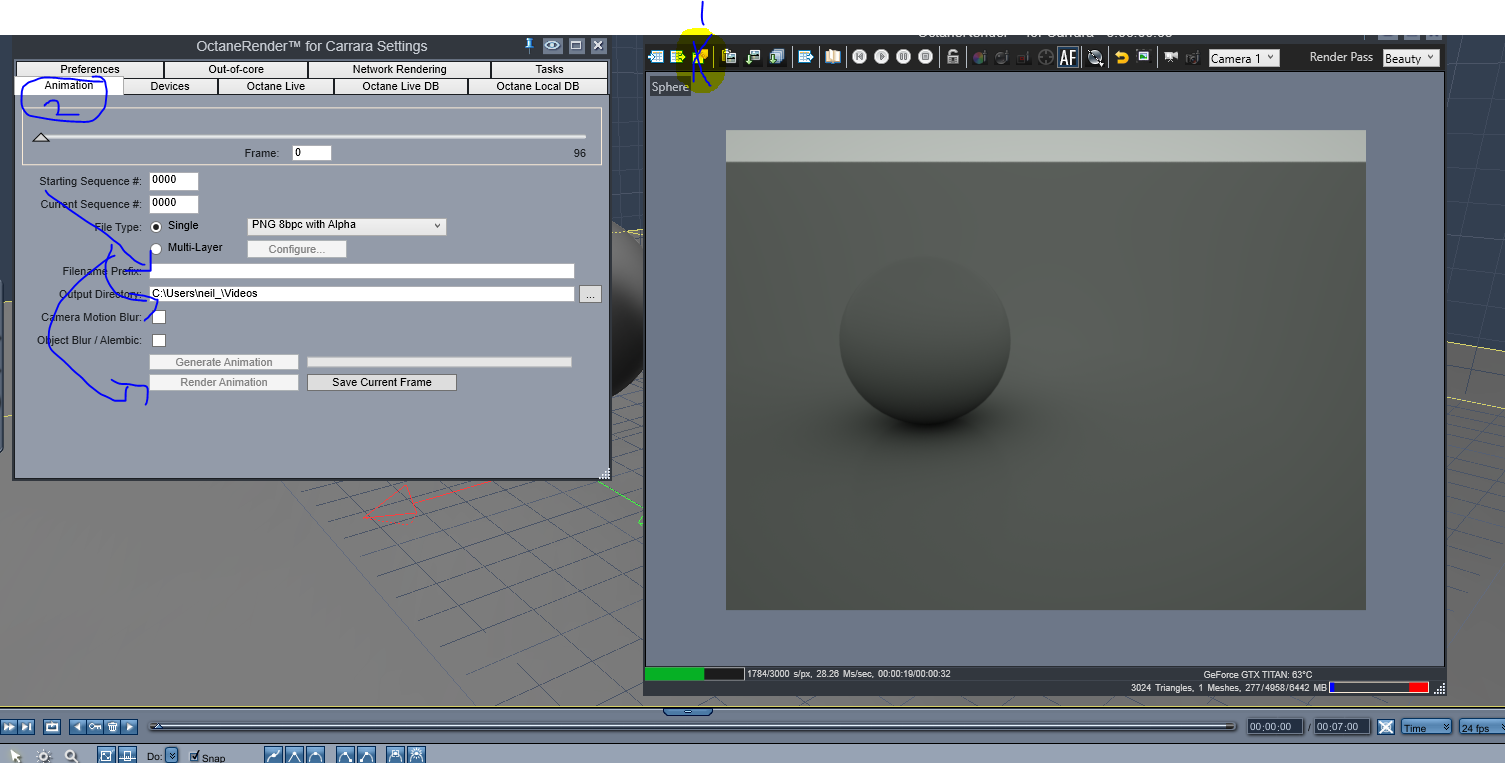

Do you mean animation render from octane render settings rather than Carrara batch render?
I think you are looking for the following: animation output found at ....
Go to: EDIT/octane commands/open octane render window
Then selects open settings window (3rd icon out from left) and click on animation tab ;)
octane animation render

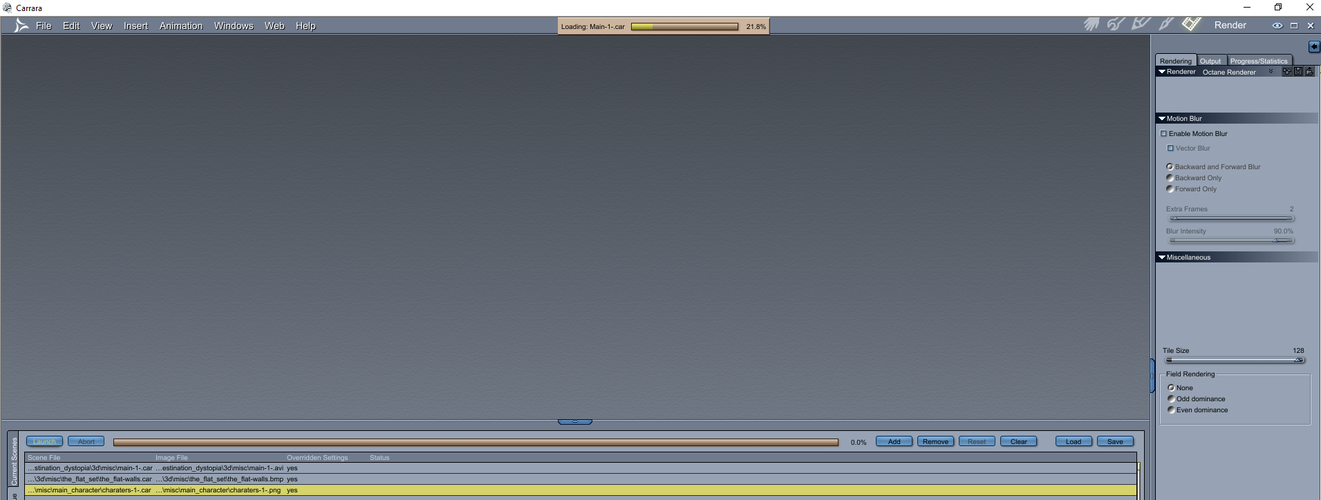

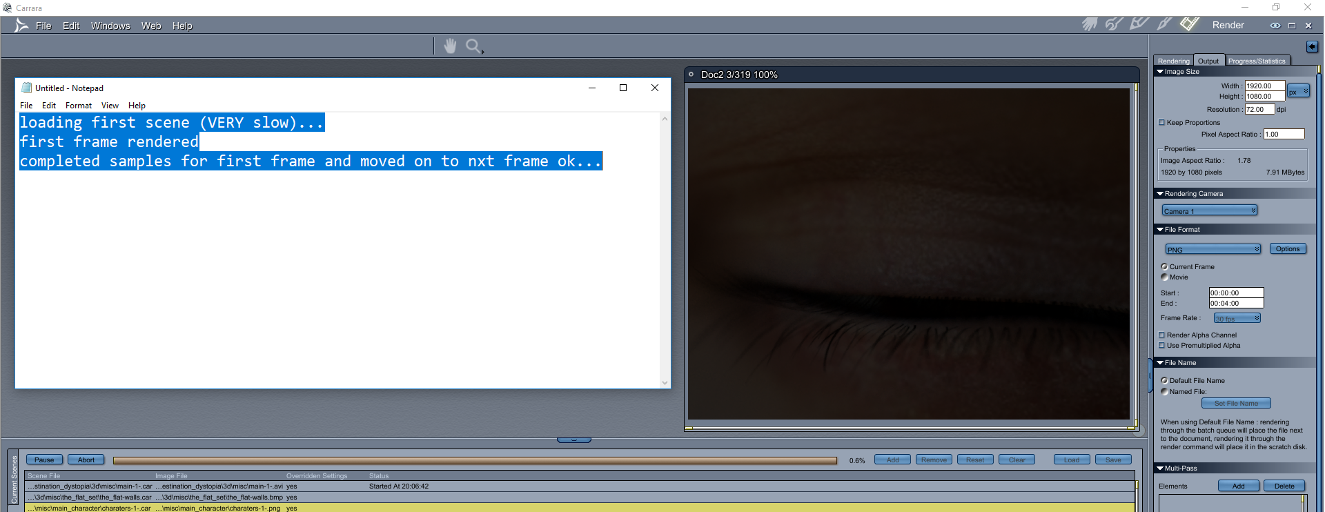

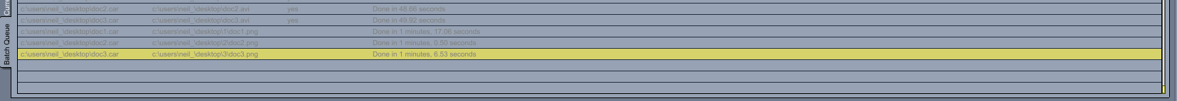

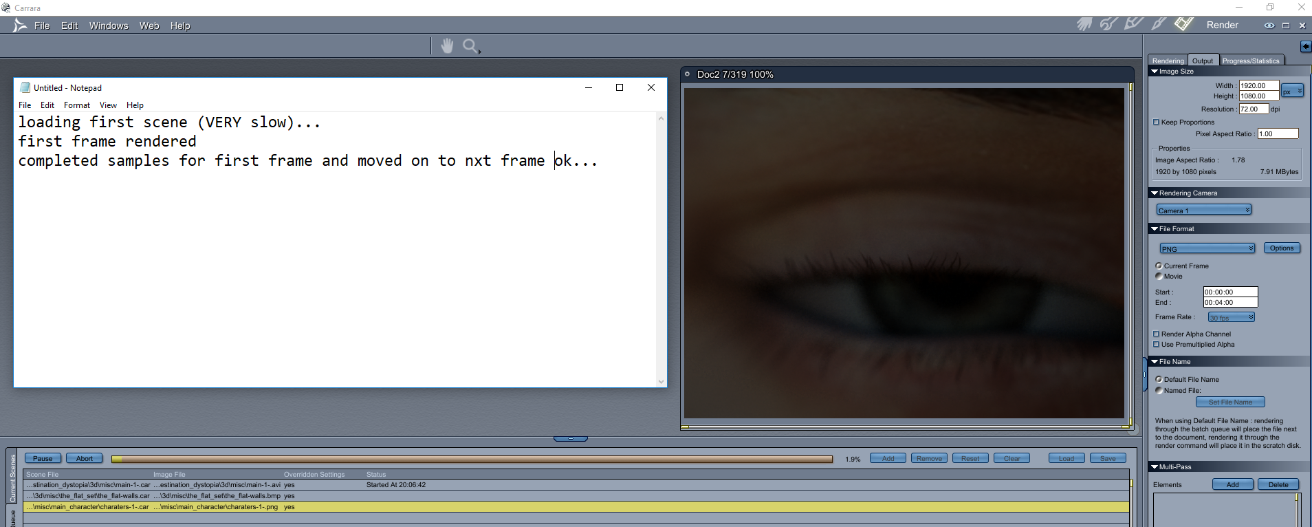

Works for me!...or 'seems' to...it is completing each frame of the first scene file....waiting to see it moves on to the next scene file... How high are your samples for each frame per scene?

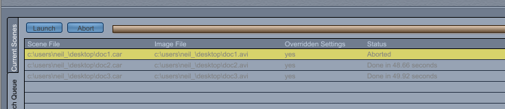

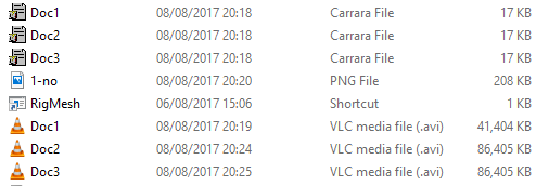

Final result on this quick test... (I did AVI but am sure PNG would be fine!) :)
User abort on first one as I wanted to try other scene files lol
end

I Used these steps:
load file into Batch Queue
designate format and destination
select Octane Renderer from drop down
Launch
Also, please know that the Batch Queue did work for me with the previous, or prior to previous, version.
Finally, is it my imagination.....seemed that excluding load time for the initial first frame, render time for Batch queue rendering is slower than straight Octane rendering??

No problem (always happy to help, if i can!)..i am a little rusty though (sorry lol)...
Yes, those steps..doing a PNG seq set now...

All was ok with seq PNG's for me too ;)
