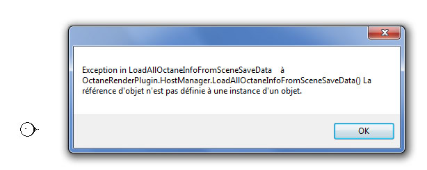

hello,
I use the plugin "OctaneRender for Revit 2014 Setup 1.20a beta"
it installs correctly, but window appears:
Then the plugin can only start if I'm on a 2D view and if I do not quickly pass a 3d view, relives crash.
Where is the problem?
thank you for your help.

Hi Didier
The plugin saves the scene data against the "Project Browser" scene object. I suspect that on the French version of Revit the "Project Browser" has a different name. I will download and install French Revit 2014. In the meantime, could I trouble you to post a screenshot of your project browser window pls?

Thanks - it will take a while for Revit French to download. In the meantime I will upload a version which handles this situation better, and tries to get the Project Browser by the term "arborescence du project". Should be uploaded in the next hour or so. I will post here when done.

effectively, the browser is not found

Hi everybody, i have the same message, but all is working well. Look at the short video.
Salut Didier, que ce soit sous revit 2013 ou 2014, j'ai effectivement le même message.
Par contre cela fonctionne.
Pour lancer l'octane view port, il faut obligatoirment être sur une vue 2d.
Ensuite, on active le plugin, et on clic sur open viewport.
Il faut alors choisir non pas une vue 3d mais une vue de caméra, il n'y a que celles là qui marchent.

Thank you Curci, for your solution but often Revit crash when even if I'm not fast enough in choosing the 3d view.

Hi Didier - did you download and install the updated plugin? The update should stop the crash. If you are still getting a crash, pls provide details of the crash message. Also, what release of Revit or you on?
I have tried installing French Revit on 3 separate PC's now and cannot. I am re-downloading - perhaps the installer is corrupt.
