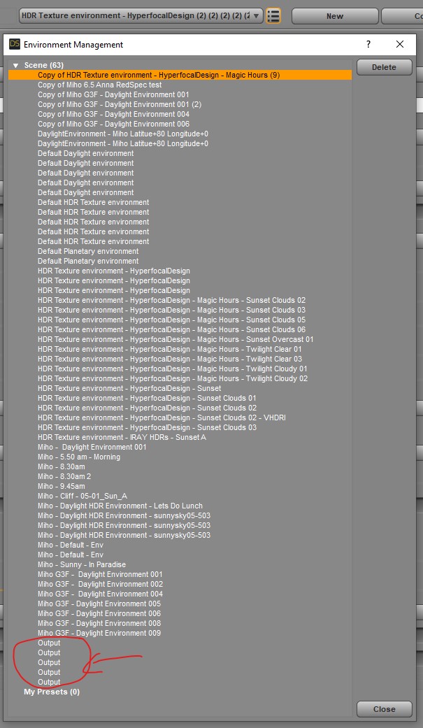

3. Thank you for the environment deletion list. I had asked for that a long time ago and though Paul had added the deletion button it was a pain to use when there were a lot of environments imported for the scene. Your current implementation makes it a breeze to delete the old and not needed environments. Btw. there are a couple of bugs I found in it:
i) I see multiple '
Output' nodes/environments listed in the list. Attempting to delete them resulting in a crash. I think those are internal to Octane. Can they be hidden from the list so that no one accidentally attempts to delete causing a crash ?
- Output nodes in the Environment Deletion List
ii) Also in the above Image, the name in the drop down
HDR Texture Environment - HyperfocalDesign (2) (2) (2) (2)... is not listed in the deletion list with same name. One of the
HDR Texture Environment - HyperfocalDesign in the list refers to it. Making it difficult to figure out which one is the current one. Can the current one be made bold or italics in the list so that it is not deleted by accident or at least it allows us to see which one is the current one as the name does not seem to match up.

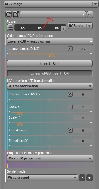

Can you fix this long standing bug - If the image file path has an
& character, Daz can load the image, but the Octane plugin cannot. That is actually a valid character for Windows file path.
- Special character causes file not to load in Octane. Here Daz shows the Jacket, but Octane does not.
- NGE - The Image path is not set because of the special character
