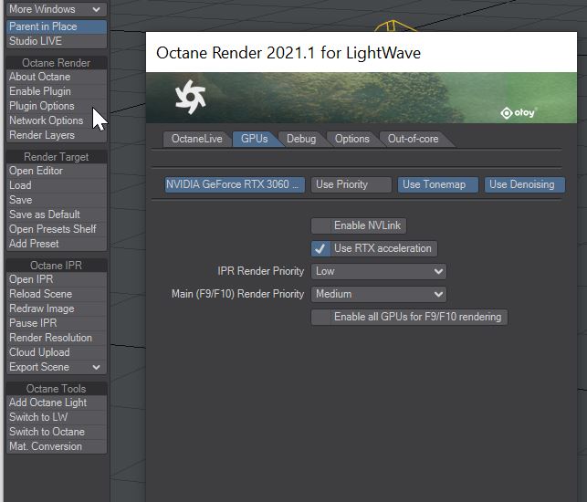

Hmm, in this case, the LightWave 2021.1.7.0 plugin should also work. What do you get in the GPUs configuration panel?

juanjgon wrote:What do you get in the GPUs configuration panel?
Where I can find this panel ?

In the plugin options panel, where you can configure the GPUs and so on.
