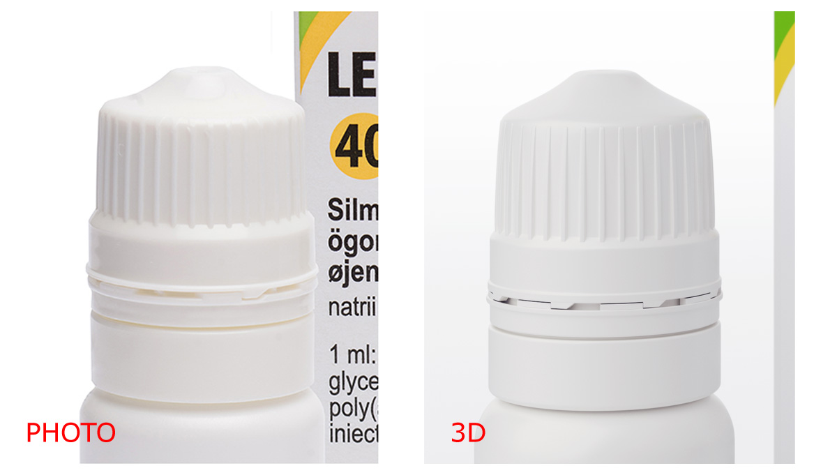

I´m trying to achieve a little more photo-realistic results with plastics.
If you have some tips, I would like to hear.
Please see the attachment:
The pic on the left side is a photo and the one on the right is my 3D-pic at the moment.
I like how the thin parts are having some yellow absorbed light and not dark shadows like in my 3D-version. I know this should be achieved with Absorbtion or Scattering mediums but I can´t get it to work. What should I do?
Why is it possible to set SSS-medium to diffuse and specular noded but not to glossy node?

Use Material Mixer and blend Diffuse (w/ SSS) with Glossy. Maybe there is a similar plastic in LiveDB for you to reverse engineer. I don't use db myself.

Can someone teach me how to get some translucency to the corners and thin parts.
I can´t get anything to work.

Have you tried the SSS presets on 3DXYZ? I believe milk or wax would be a good starting point for the effect you're trying to achieve. Here: http://3dxyz.pro/sss-material-starter-pack-octane-render-for-lightwave/
