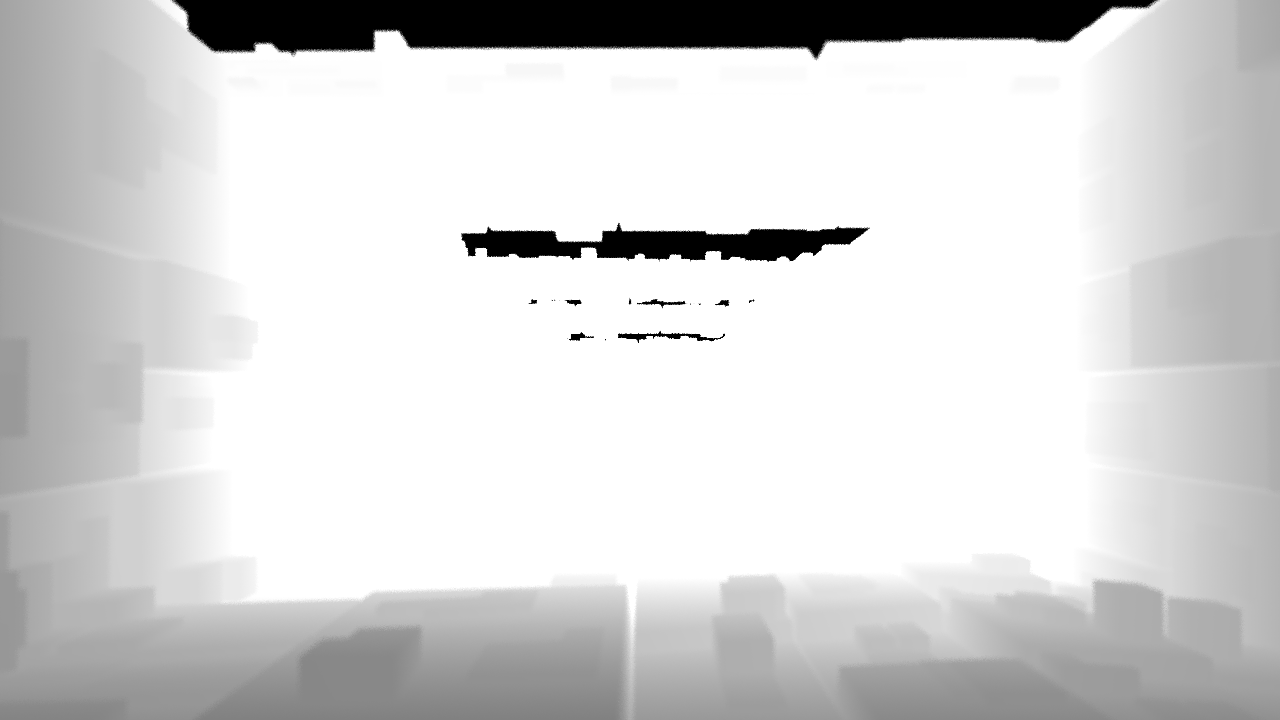

Sorry, I've no experience with Fusion, so I'm sure how to resolve your question about the ZBuffer. I suppose that if the buffer is inverted you could invert it using a Fusion node.

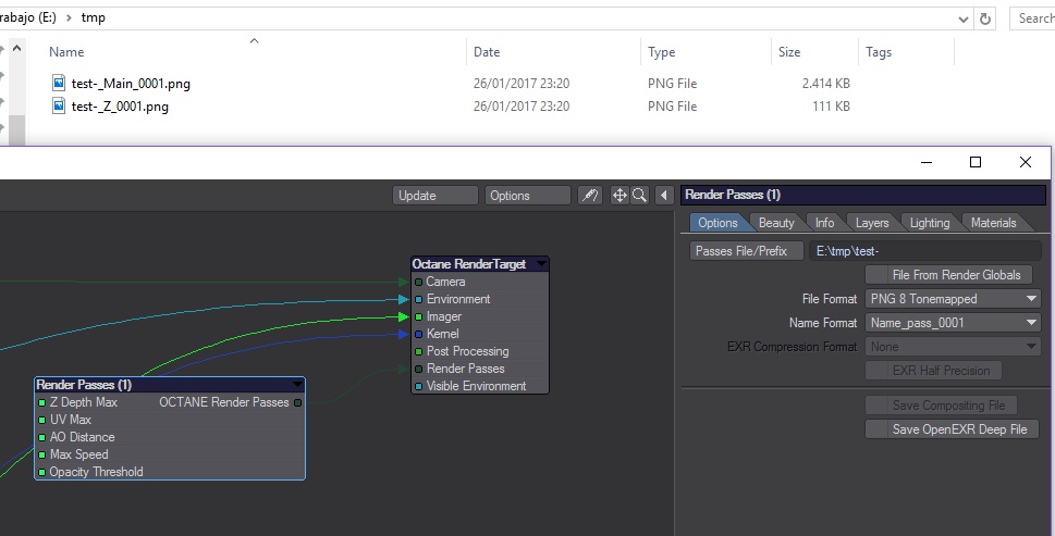

About your second question, as soon as you enable the z depth pass and configure the passes file options, you should get always the beauty pass along all the other selected buffers, unless you select a multi-layered EXR output. In this case all the passes are going to be including in the same EXR file.

juanjgon wrote:I have remembered an issue related to the render passes fixed some time ago. Are you working with the latest build?
