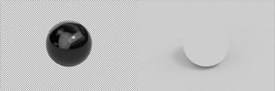

Hello.
I'm on the next stage of exploring Octane and have arrived at render passes. Here's a question. Is it possible to have a "normal" pass (containing) all the objects and the shadow pass in one rendering like in the image below? I know it's possible to use render layers, but that would mean twice the render time. And as I usually render very high res images (8K+) this is a significant amount of time. Thanks for any advice.

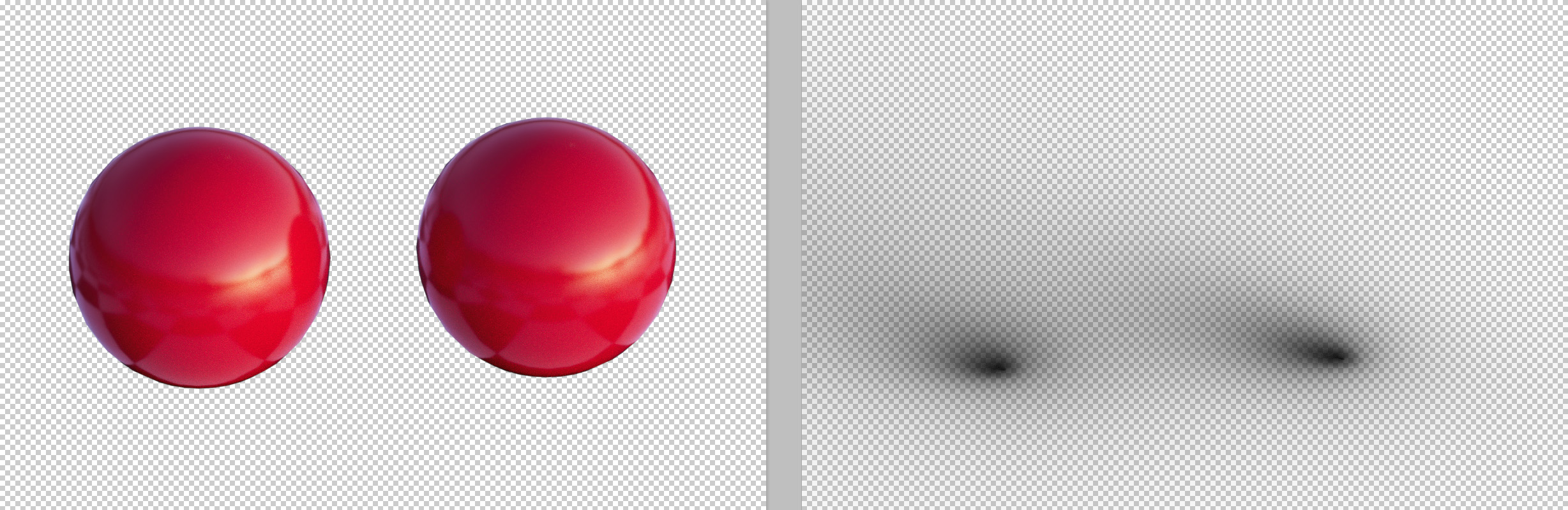

It's possible in one render run. If the "Shadow Catcher" is activated as a render pass, the objects and the shadow catcher are separated like this. Here a plane is below the sphere and it's marked as a shadow catcher in the object settings.
But I guess I can come to a similar result if I extract the objects from the combined layer with an object mask.

Andreas_Resch wrote:It's possible in one render run. If the "Shadow Catcher" is activated as a render pass, the objects and the shadow catcher are separated like this. Here a plane is below the sphere and it's marked as a shadow catcher in the object settings.
In your previous example the shadow were not masked by the obejct, that's what I was thinking you needed.
Re: Combined and Shadow pass in one rendering?
Posted: Wed May 17, 2023 5:01 pm
by Andreas_Resch
Yeah. That's not possible in Blender either. Not in one run. But I think I will go for extracting the objects from the combined pass. I hope I don't get any issues around the corners.
