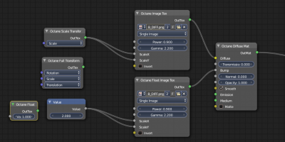

Alpha leaves, no problem in Octane standalone, use a white and black (yup the opposite of the usual) image of the leaves in the opacity channel to mask them out:
But I haven't been able to achieve it in blender, nor have I found a node for opacity
any ideas?

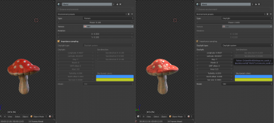

Oh yes, and please don't forget about my camera question
I also just tried the beta for linux and it's working great as well, this is all so exciting! I still don't know where it finds the installed/authorized octane standalone in the system as it nevers asks for a path to the installed version on the system, I feel as if it's using an online-streaming version of Octane, hence the server application and the bigger lag in the viewport compared to standalone?
