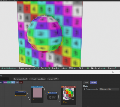

ofirgardy wrote:Yes. I understood this just like you did. But failed to recreate.
Do you have any idea how to implement this (even in C4D) I guess I could match it in Max.

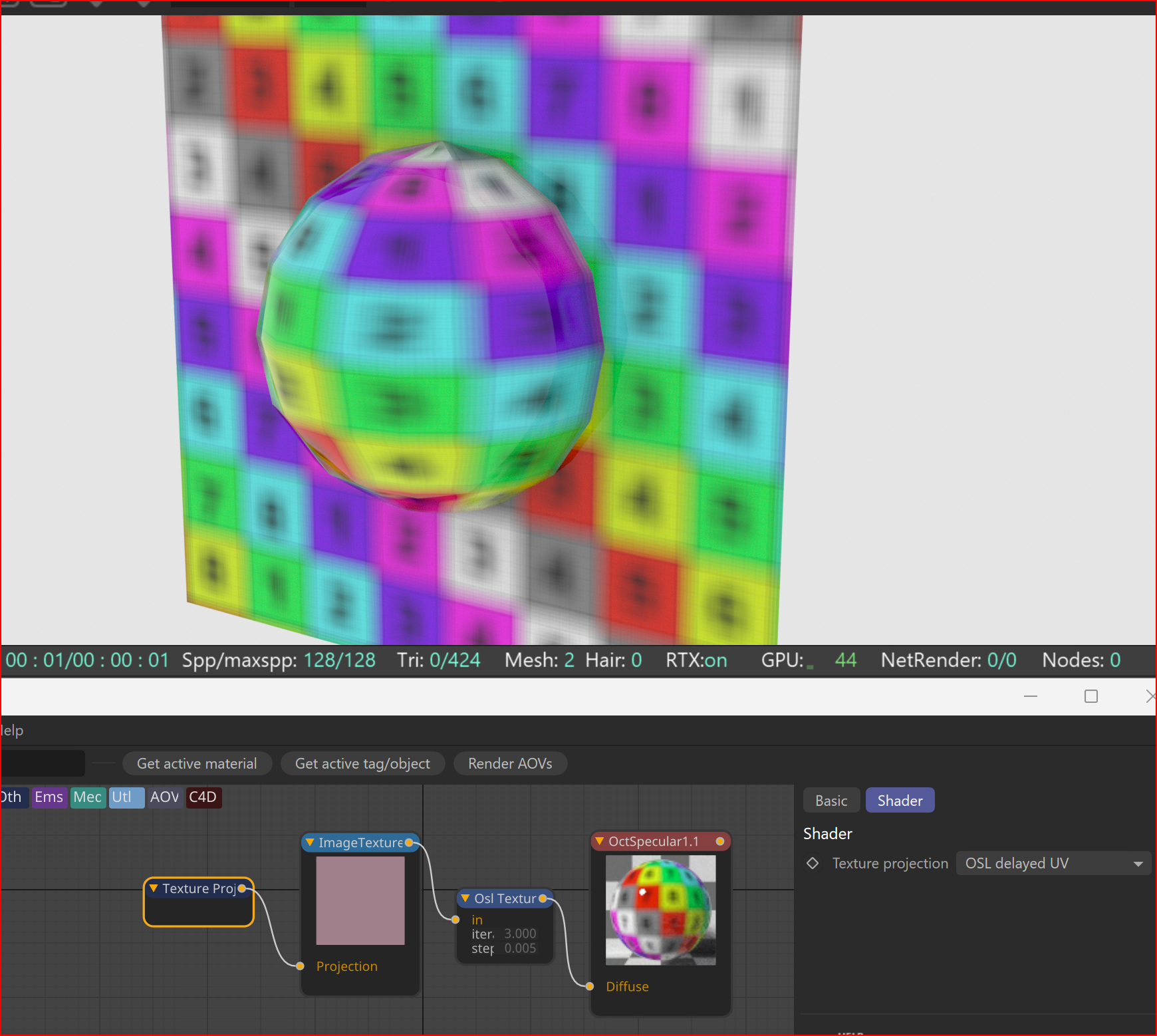

ofirgardy wrote:I can see you've started with a specular material.
then plugged what? the Blur.OSL into the Albedo? or is it another type of OSL there?
Then second is the Checkers? or is the Second one titled "Image Texture" is that the Blur.OSL?
the last one - the delayed Projection - this one is straight forward
