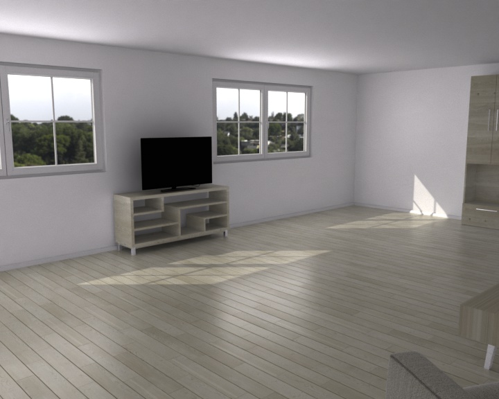

Postby Conna3005 » Tue Mar 05, 2024 6:26 am
Conna3005 Tue Mar 05, 2024 6:26 am
Great Thing.
I finally managed it.
If you render the manager you have to set Project/Raw.
After the sekond render the ICIO is set.
I have made a new Light Setup and worked with Octane Tag. At least 6 different Light Groups.
At least with the fitting Textures it goes well.
At the moment i am not able to set a Allround Light Setup. If i want to drive the Cam from one Corner to the other it does not work.
I am limited to a vierto the Leftz or Right. Without Cam rotating.
If you know a Technique how to set the Light for the whole Room give me a Hint.
Here are my Renders. 6 Lighting Groups/Octane Tags.
