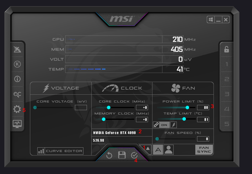

If you don't have access to extra parts for testing, you can also try using MSI afterburner to lower the power limit on both cards. Set it to about 70-80%. You lose very little performance in Octane (1-3%). I've done this in the past to keep things cooler and more power efficient too.
