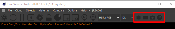

Postby AWOLism » Fri Apr 16, 2021 11:27 pm
AWOLism Fri Apr 16, 2021 11:27 pm
mitchino wrote:I don't think I have this button. Where is it?
C4D R2023 + Octane 2022.1 | Windows 10 Pro | 64 gb ram | 1 x RTX3090
