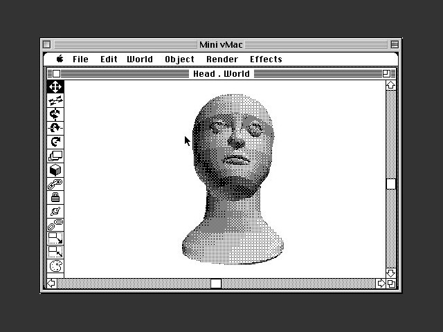

edit: So I did the test. An old dog can learn new tricks: a 4096x4096 RGB texture takes nearly the same VRAM as 4096x4100. And while an 8k square texture does in fact take four times as much memory as a 4k square texture, there's no real disadvantage, memory wise, to using a 5.7k texture, which will use about twice as much memory as a 4k. Similarly, a 4kx8k uses 2x the memory as 4kx4k. This may seem painfully obvious to some of you, but it was not always so. I guess I'll just go back to working in Swivel 3D on my 1987 Mac II.
