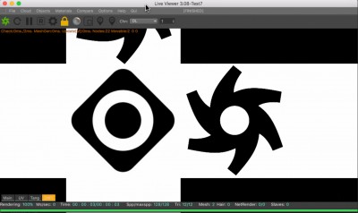

assuming that the mesh with triplanar node has proper unfolded uvs, you need to use the triplanar in diffuse, then use a baking camera:

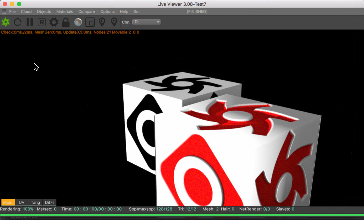

and use the resulting texture in displacement, the cube in the back is the triplanar baked cube:
ciao beppe
