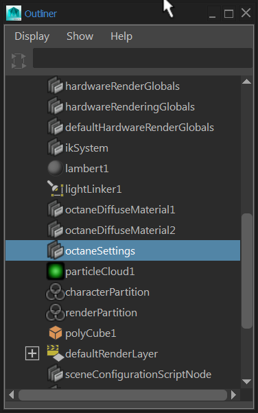

It's possible to make your own presets for Octane render settings:
you have to select the octaneSettings node in the outliner (disable "Dag object only")
then using the Maya builtin preset feature, you can save the actual state of the renderSetting as a preset that you can apply later.
But obviously it would be way more handy to have this accessible in the Render Settings.
