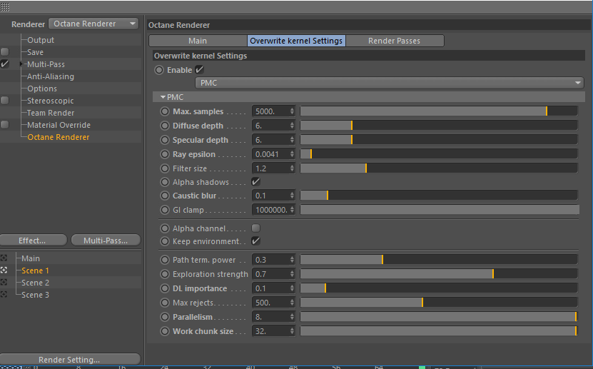

I'm working on pretty complex scene in C4D with a lot of different lights and glossy mats. I chose to go with PMC to get rid of hotpixels in PT. I thought that some extra rendering is not a big problem as I have 7x1070 GPU farm(PC2)...but here's the thing..it's slower on PMC algo than 2x1080(PC1).
This problem only appears in PMC algo, so I don't really understand what is the problem.

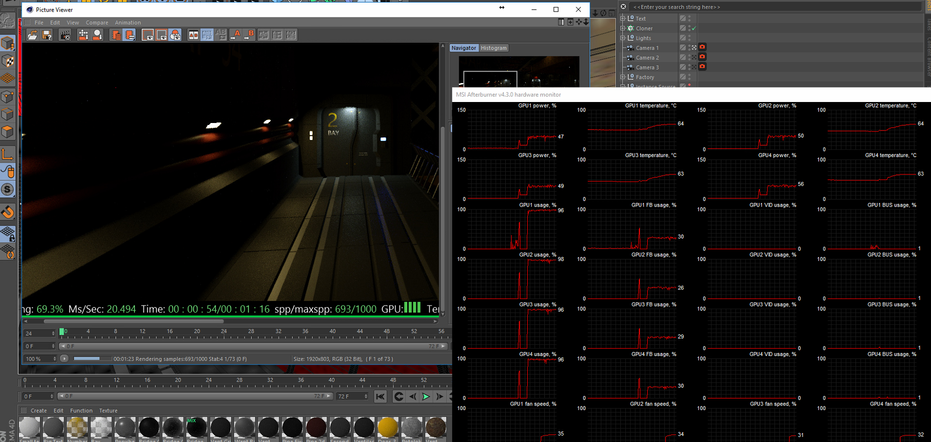

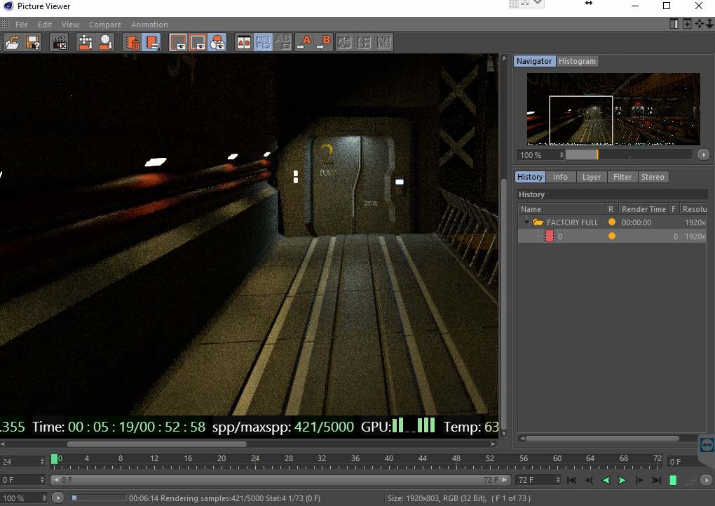

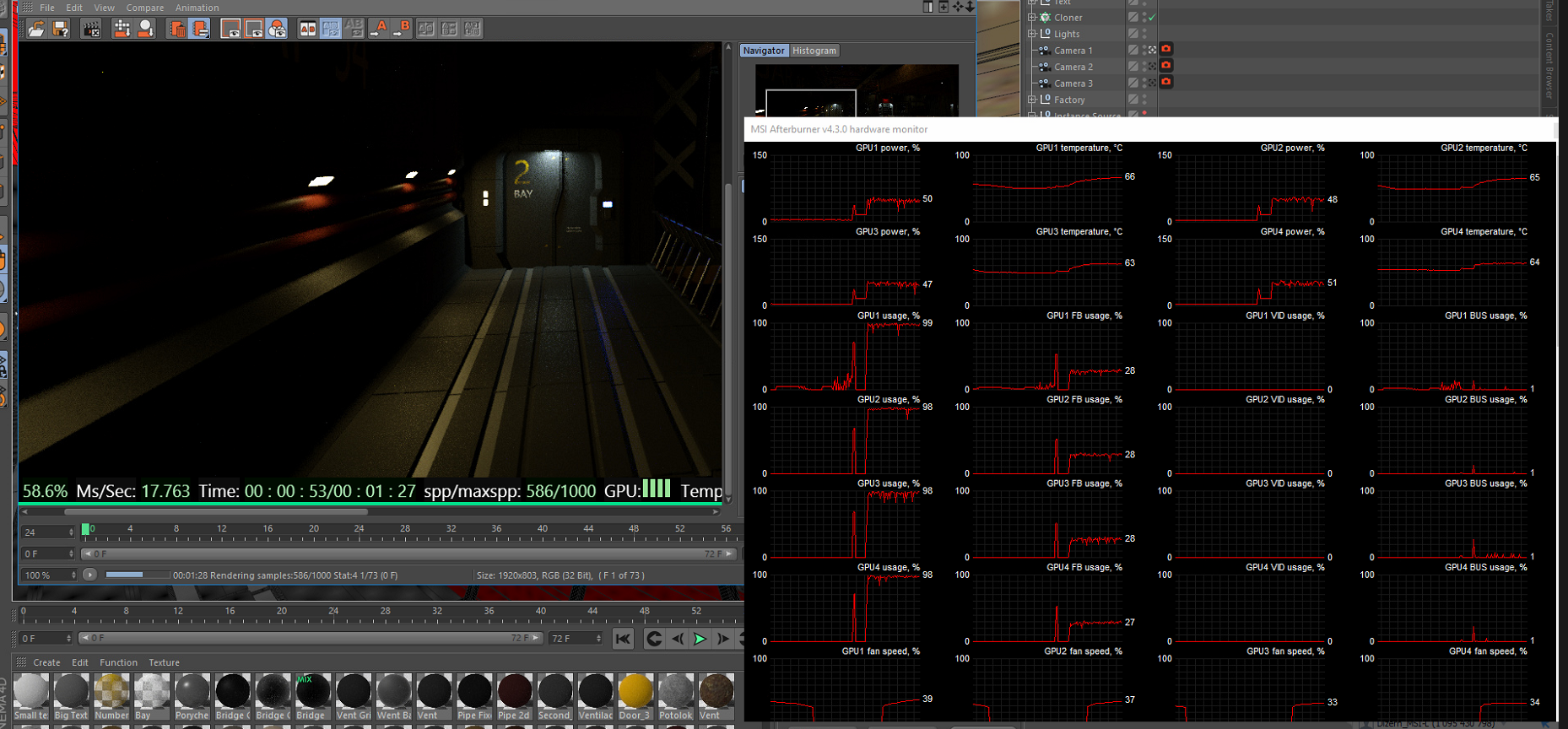

Here's few screenshots:
PC1 stats

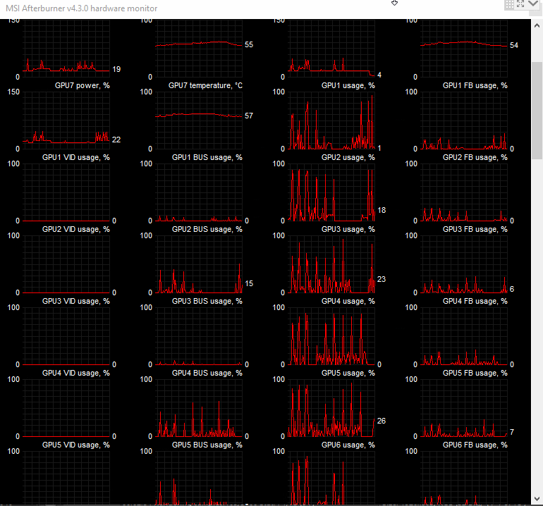

PC1 GPU usage
PC2 GPU Usage
PS2 Stats
Render Settings

The situation goes better with render without multipass. The results are 7x 1070 are twice as fast as 2x1080....but it should be 3x fast.
It uses all the cards, but I see big gaps on graphic anyway.

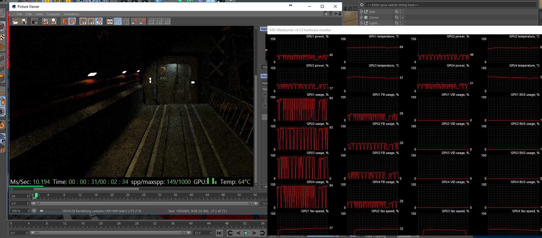

Tom, I've removed x1 extenders and.....the picture is still there :(
1gpu in mobo, 3 on ribbon risers. I don't understand why it works so bad in PMC_MP only...
Here's the graphs with 4 pgu and 1graph with 1plugged gpu only:
PMC_MP
PMC_noMP
PT_MP
PT_noMP
1GPU_PMC_MP
