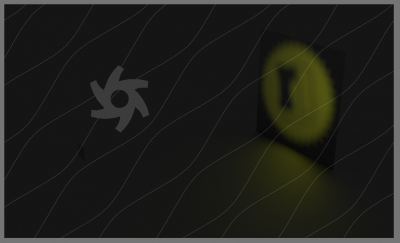

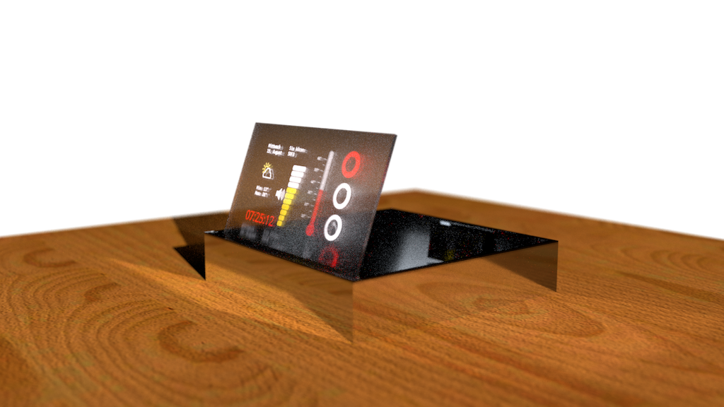

I've searched in the past days for a render software which can do this setup:
A light source which casts a bitmap image or movie via a mirror object onto a wall..thus simulating sort of a beamer...
So far I only stumbled upon LuxCore render which does the job just perfect inside Blender, but as it requires bidir rendering no GPU acceleration is possible (though LuXCore uses all CPU even when rendering through GPU ;o).
Is this something that can be done in Octane without bidir rendering?
Attached the output of LuXxCore renderer inside Blender 2.79b.
LuxCore rendering in Blender

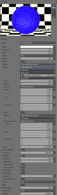

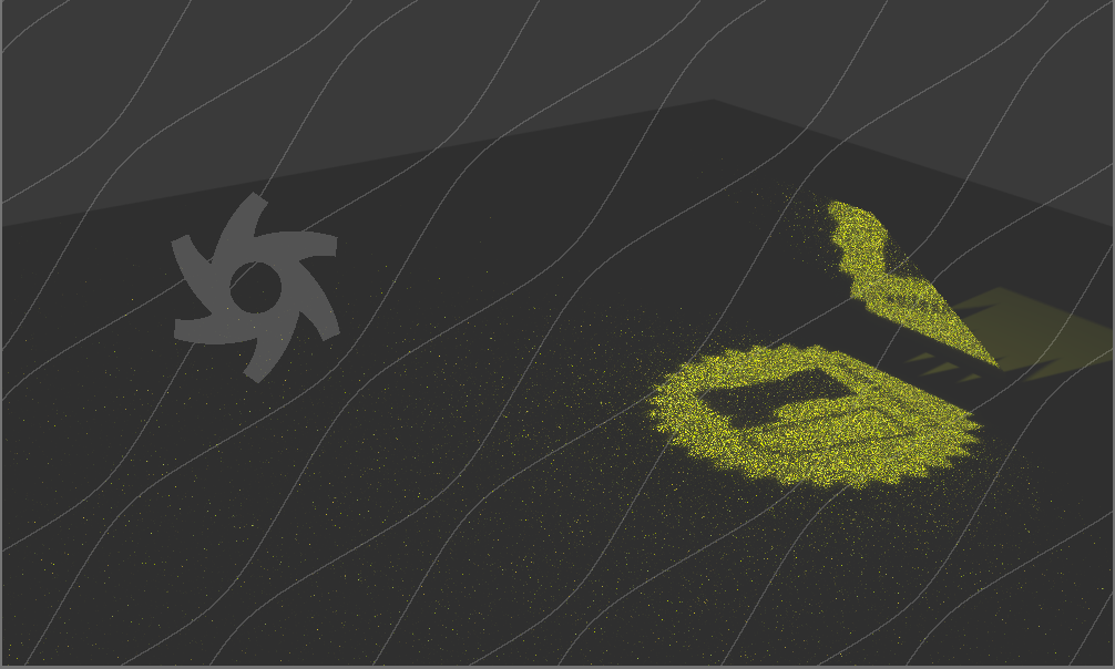

Hmm..this C4D example looks like a way to go...though there are several settings which just don't exist in the blender plugin... https://www.youtube.com/watch?v=3IVCXIuHDeo
I get something projected but makes no sense at all....
Guess I have to continue to use slower luxcore renderer...

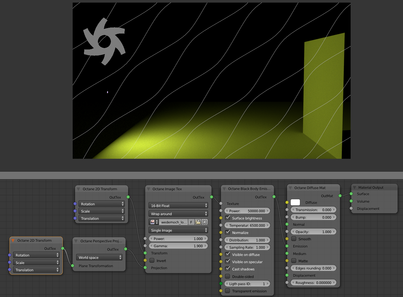

Nodes
Preview
Rendering

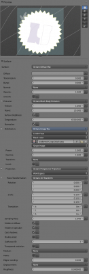

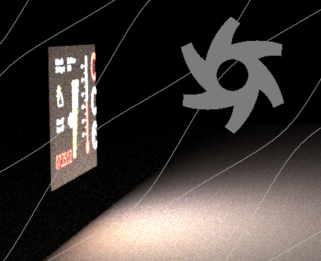

Starting over again...set the emitting plane a little bigger so I can see the texture..
When I set the border mode of the texture to "wrap" the texture is around the same size as the plane and it emits light...
As soon I set the border mode to "black" the whole scene is dark...

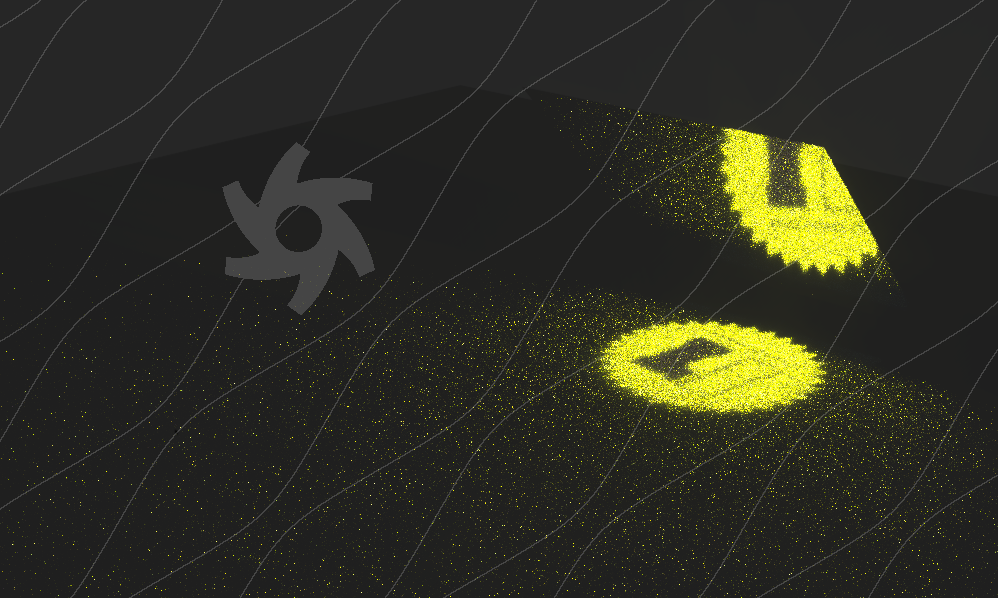

Postby davorin » Mon Oct 22, 2018 1:06 pm
davorin Mon Oct 22, 2018 1:06 pm

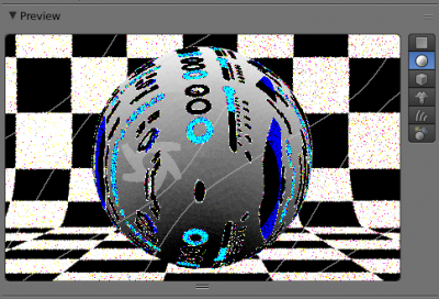

No matter what I try..I never get anything that cast an image onto anything....
And I can't export it to test in standalone OctaneRender...
Also the option "Surface brightness" only shows effect in the material preview...but not in the render output...

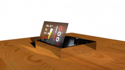

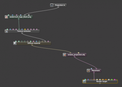

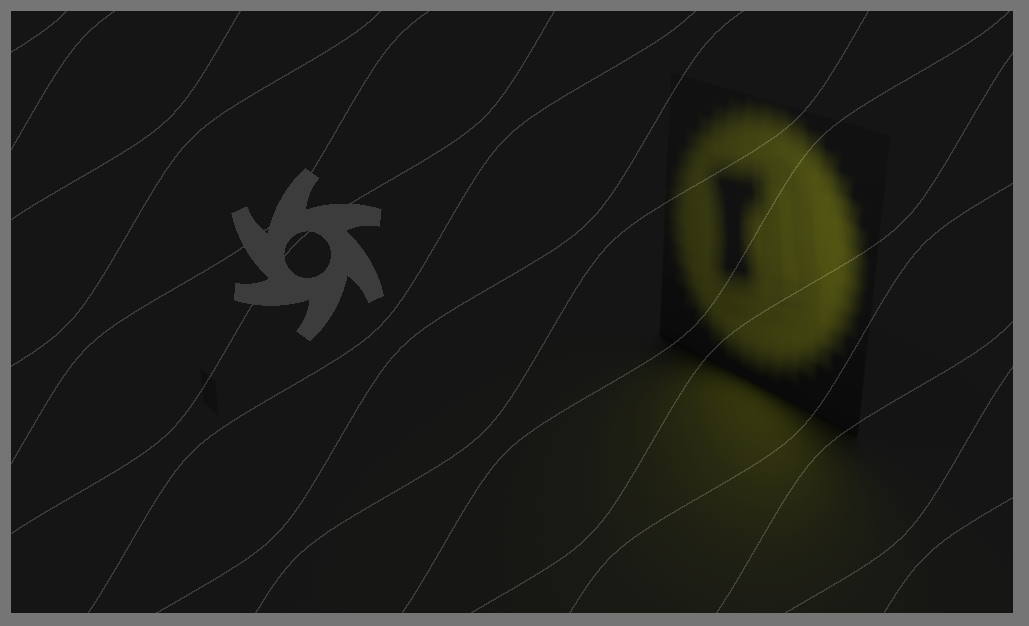

Tried now a quick setup in standalone version though I never used...but seems to work on first try...
the mesh object is still too large though as the projected image is blurred...
Trying then to map all settings back to blender scene...

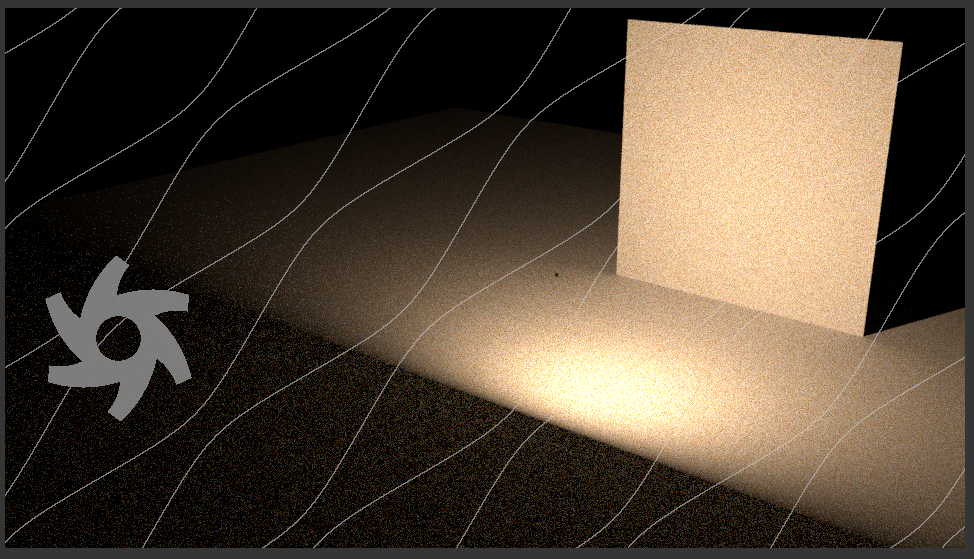

Re: Beam image via mirror object onto wall
Postby davorin » Mon Oct 22, 2018 2:39 pm
davorin Mon Oct 22, 2018 2:39 pm
Works in the standalone version with path tracer...
Though after 5000 samples way worse looking than with LuxCore renderer ;-)
Postby davorin » Mon Oct 22, 2018 3:16 pm
davorin Mon Oct 22, 2018 3:16 pm
Can't get the image any better...just lots of ugly noise in rendering...
Postby davorin » Tue Oct 23, 2018 8:09 am
davorin Tue Oct 23, 2018 8:09 am

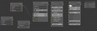

It just does not work with the same setup in blender as in the standalone version...
The preview is shown correctly with the projection...but just dark in the render output...
So what is different using the blender octane version compared to standalone?
