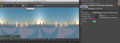

here is a simple scene with a 360° panoramic camera made on a mac with the v2.12:
C4D-VR-360.c4d.zip
(30.19 KiB) Downloaded 391 times
newer versions of the plugin can be set to stereo side-by-side or over-under plus other parameters for stereo rendering ;)
ciao beppe

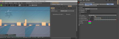

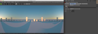

Thanks for the reply bepeg4d,
Unfortunately I don't get the same result with the latest DEMO version of OctaneRender + C4D Plugin.
Judging your screenshots I believe that it's possible in the full version, so thats nice!
Is it broken in the demo or unsupported?
Re: Enabling Panorama in Cinema4D
Posted: Wed Jul 15, 2015 1:29 pm
by bepeg4d
you are right, it is broken in the demo version, basically what happen is that changing the camera type between Thin-lens and Panoramic does not have any effect:
but, as you have seen, works smoothly in the commercial version ;)
ciao beppe
