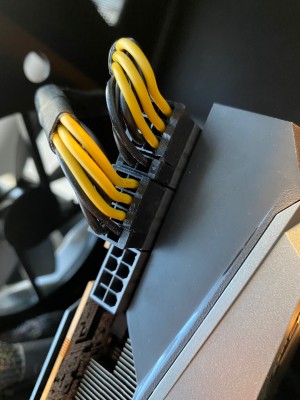

Hi snahbah.
How did you get the 6900XT in the razer core X? It wouldn't work for me due to lack of Power slots:
6900 XT Razer Core X slot
