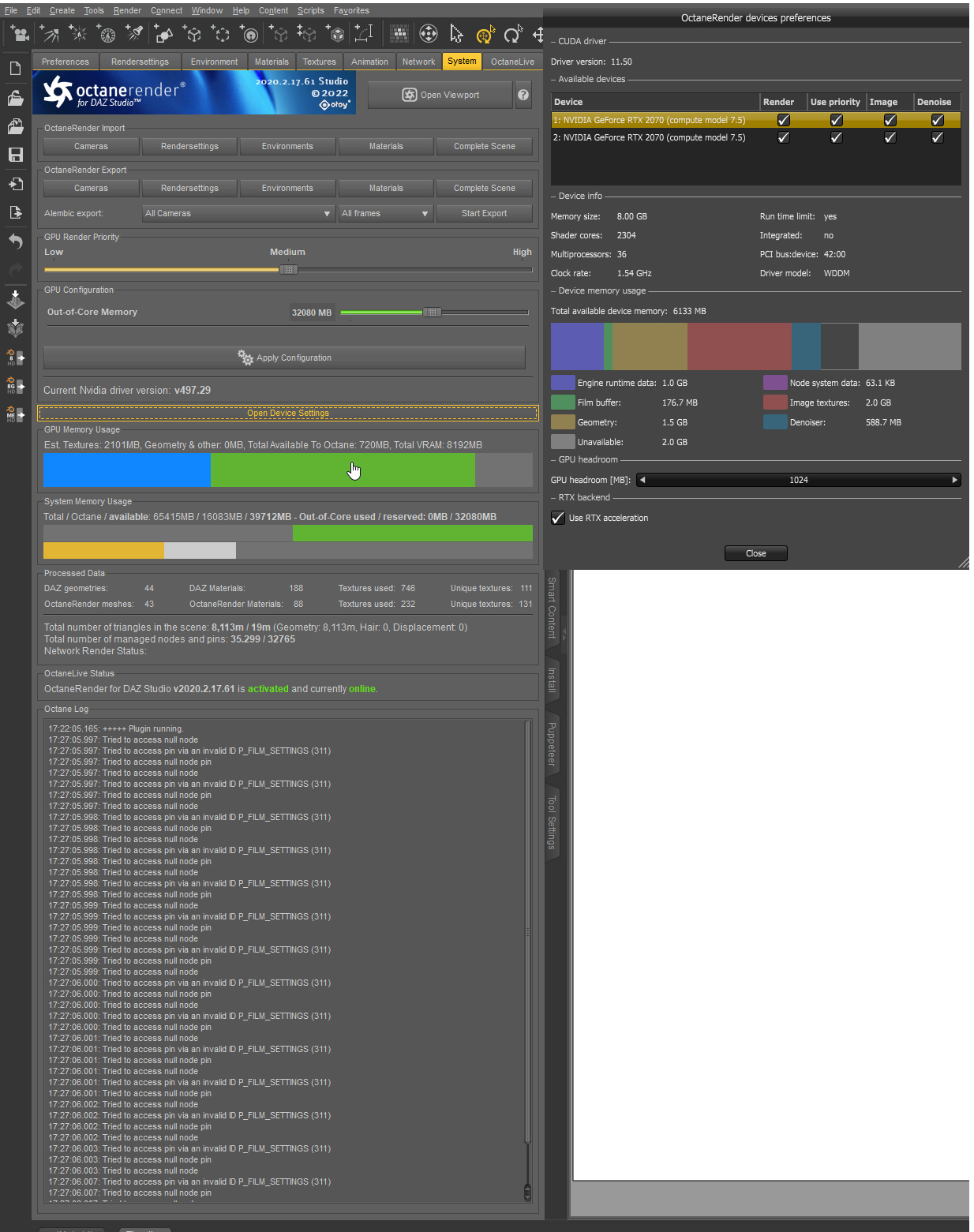

However, the normal render of the first frame is saved, but never any other passes, for example the denoised pass isn't saved. It sometimes even started the second frame but stopped immediately at 1 or 2 samples, because of the memory crash.
I don't understand why the second frame starts rendering when the post processing of the first isn't finished.
I've made a screenshot of the system-tab after rendering a single image in the normal viewport and I made a screenshot of the system-tab after the animation crashed. It looks like octane tries to put geometry and textures in the memory again which leads to the crash, even though there should be more than enough ooc memory.
After rendering a single image:
After one frame of animation rendering and memory crash:
Is it possible there is an issue in the order of execution between rendering frames?
Pretty annoying too: The memory crash while rendering animations is silent. It doesn't pop up. The progress in the animation rendering window just stops. It doesn't freeze, you can close the window. In fact, you have too stop the animation rendering or open the debug log too see the memory crash. And after the crash you can't even restart the rendering. You have to close the Daz3D and restart again. Whole Process needs around 10 minutes for me -> Quite frustrating when testing what the issue might be.
So it would be nice if either the crash pops up directly or we are able to move to another view / tab inside daz3d too see the system tab.
I tried various headroom setups from 100mb to 1024mb. Didn't seem to make a difference.
