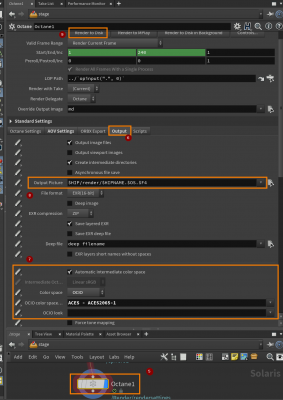

-Installation steps-
Insert the OctaneRender® plugin folder path to the houdini.env file. Houdini®creates this file after launching it for the first time.
On Linux and macOS® systems, append a single line to enable OctaneRender®:
HOUDINI_PATH = "/path/to/octane;&"
On Windows® systems, you need to set the PATH to point to the plugin bin folder as well:
PATH = "C:/path/to/octane/bin;$PATH"
Setting this environment variable outputs any error related to loading the OctaneRender® plugin on the command line for diagnosing installation problems:
HOUDINI_DSO_ERROR = 2
