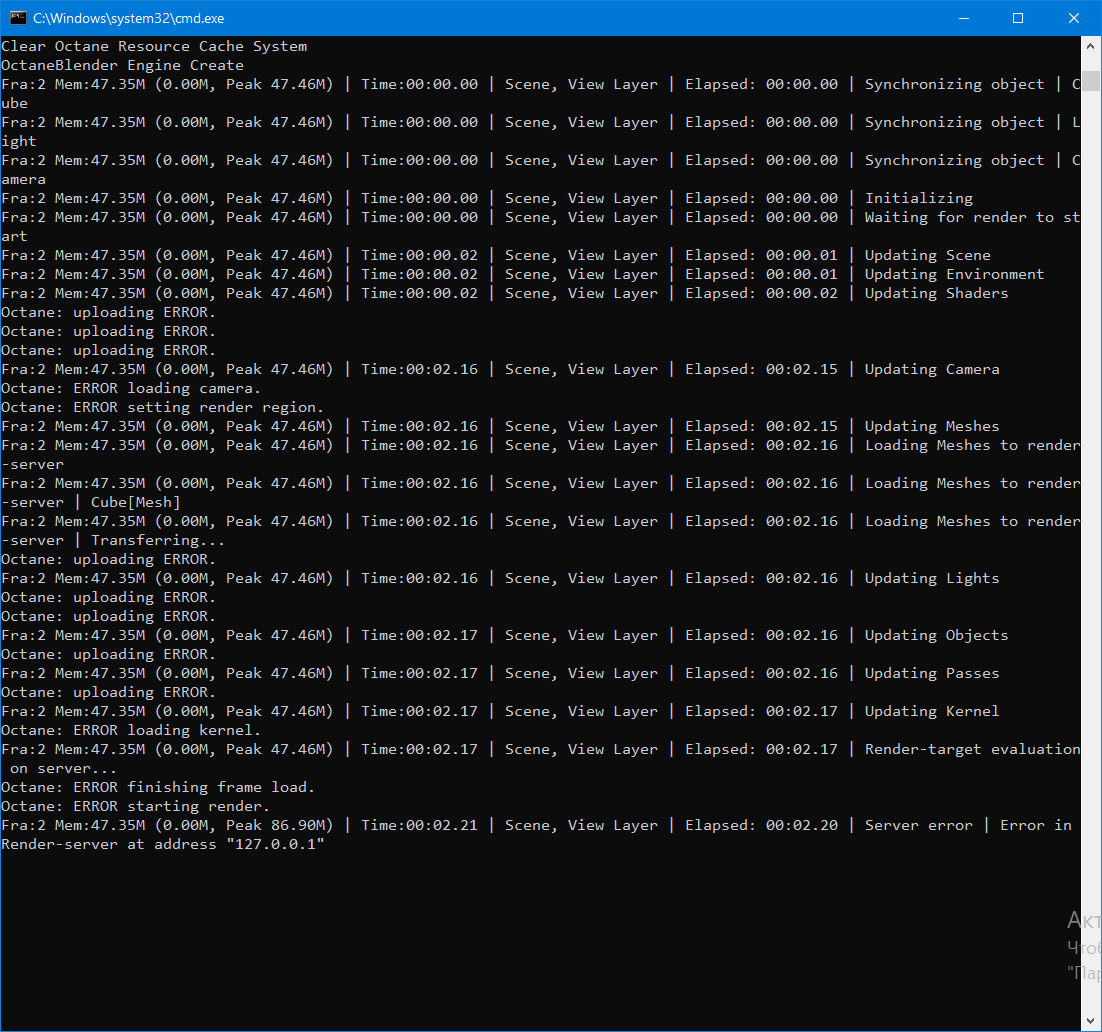

Only the first frame of animation or frame sequence is rendered correctly. Next frame crashes the OctaneServer.
Default Blender scene with a cube
Octane 21.7, Win 10 x64
CMD error

I can’t believe that no one is using command line rendering instead of UI, and no one has faced this problem yet.

Yes, this also happens in the current 21.8 version.
Here are the command line args, can be tested on the startup cube scene:
Code: Select all
"C:\Program Files\BlenderOctane\blender.exe" --background "C:\Proj\test.blend" --render-output "C:\Proj\f_" -f 0   <<-- OK
"C:\Program Files\BlenderOctane\blender.exe" --background "C:\Proj\test.blend" --render-output "C:\Proj\f_" -f 1   <<-- OctaneServer crash with Octane Kernel error
or
"C:\Program Files\BlenderOctane\blender.exe" --background "C:\Proj\test.blend" --render-output "C:\Proj\f_" -a    <<-- only the first frame of the animation renders fine, but next frame will crash the process
