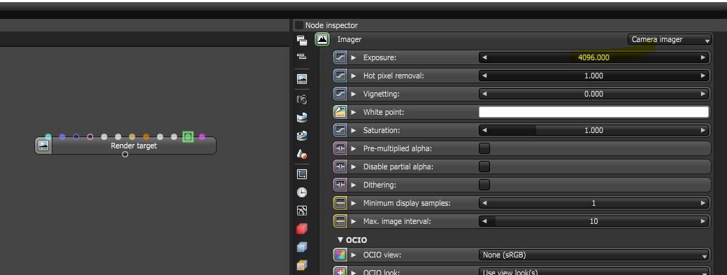

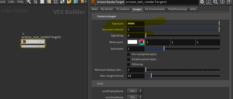

When I repeat twice that exposure slider shouldnt be from 1-1000 and i dont even get a reply, what does that say to you?
i am not sure i get exactly what you are talking about ? exposure in render target ?
because houdini match perfectly standalone here ? could you be more precise about this exposure problems ?

thanulee wrote:When I repeat twice that exposure slider shouldnt be from 1-1000 and i dont even get a reply, what does that say to you?
Sorry, probably I missed this request. I've just replied to one of these posts, although I've seen it only once, probably my fault.
