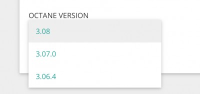

which Octane version are you using for rendering in ORC?
ciao Beppe
Re: Depth Channel, AO yellow
Posted: Fri Jul 27, 2018 5:41 pm
by peter.olieman
3.08
