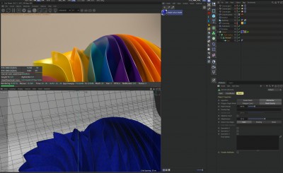

Don't know if this is a bug or user error, but the Cloth Surface generator doesn't respect the Color Shader I've applied to the child Cloner object.
I was trying to create the windows 11 background using a cloner and some cloth discs, but the shader doesn't work with the Cloth Surface generator.
If you toggle on and off the Cloth Surface generator in the attached file you'll see the problem.

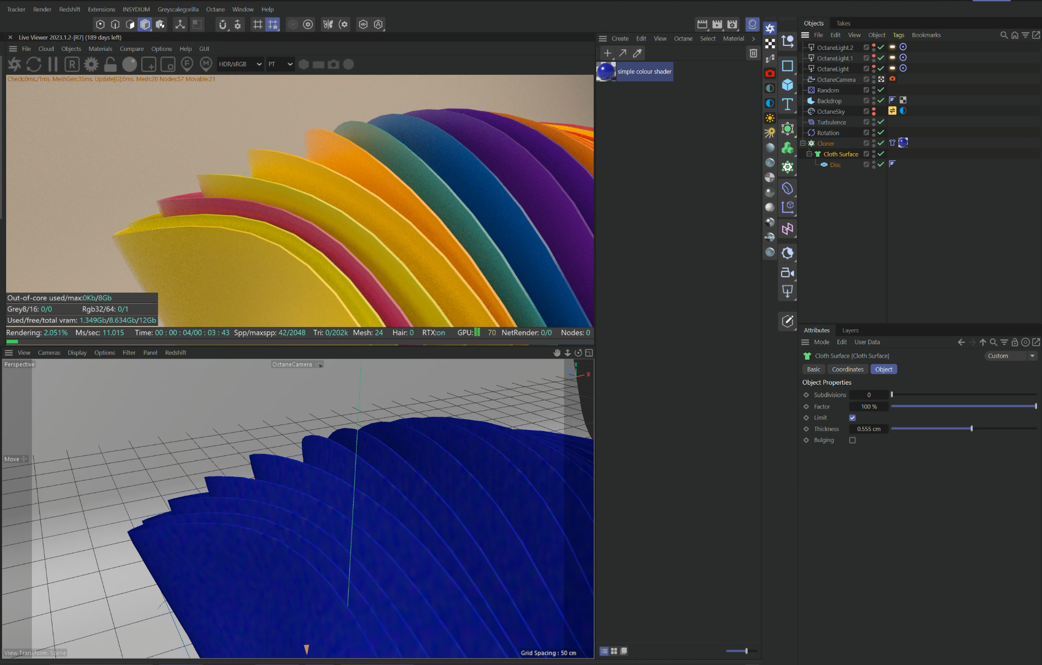

try to make the Cloth Surface parent of the disk, not of the Cloner:

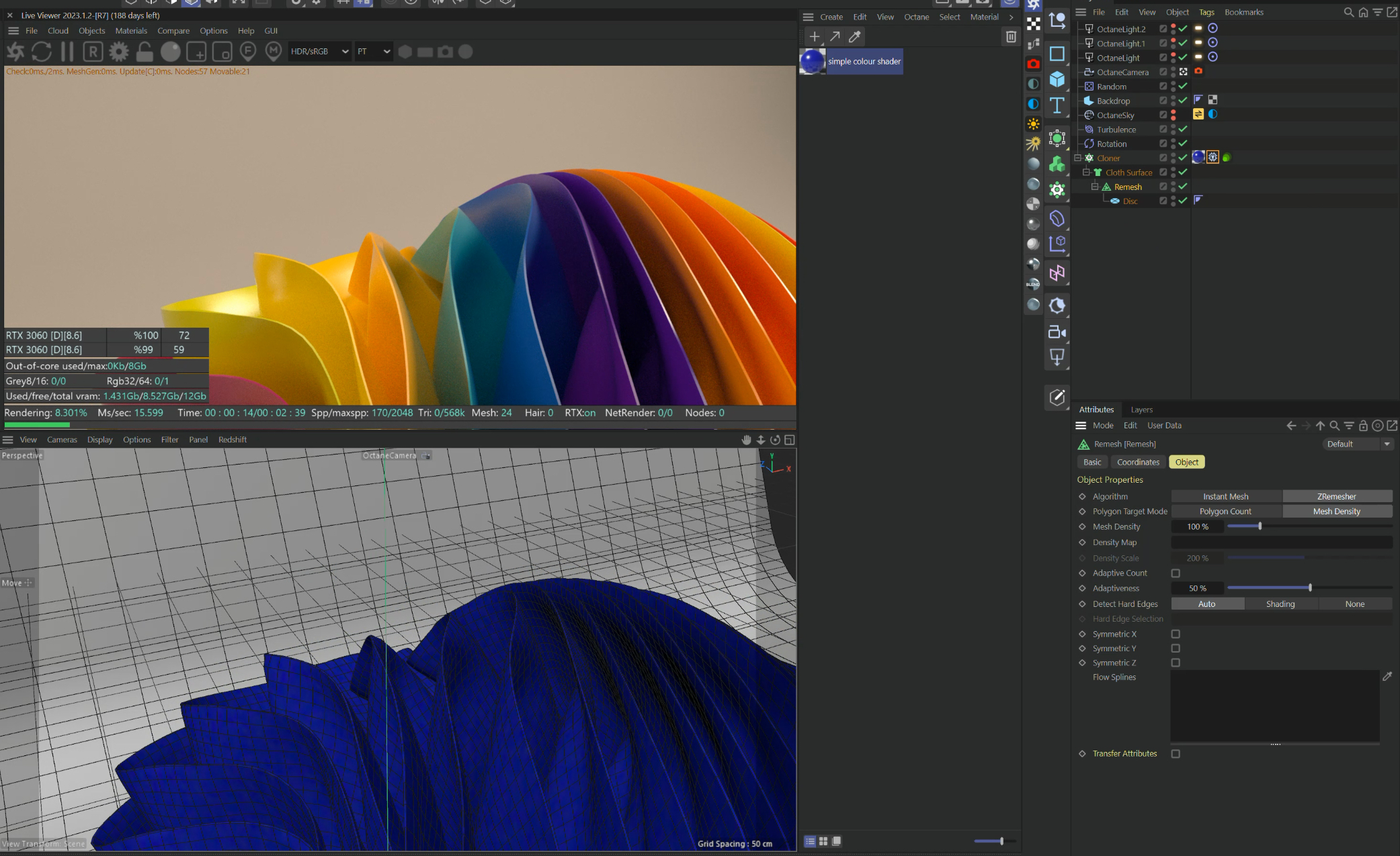

the issue is that the Disk topology is not good for deformations, but you can use a Remesh tool to have a perfect quad mesh that doeesn't have issues in deforming:

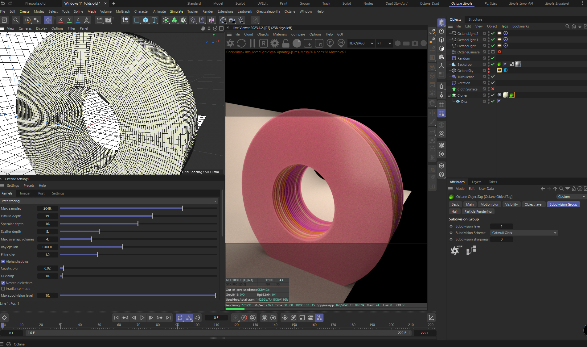

#beppe The disc has a non-zero internal diameter, so the geometry is all quads already. Unless C4D is doing something internally that isn't displayed.
