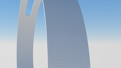

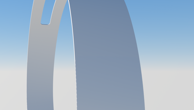

						It basically got broken with 2.20. You got results like this: while they should be like this: You still need a reasonable triangle mesh to make rounded edges work well.riggles wrote:Would you be able to give a little more detail about what's been fixed with rounded edges?

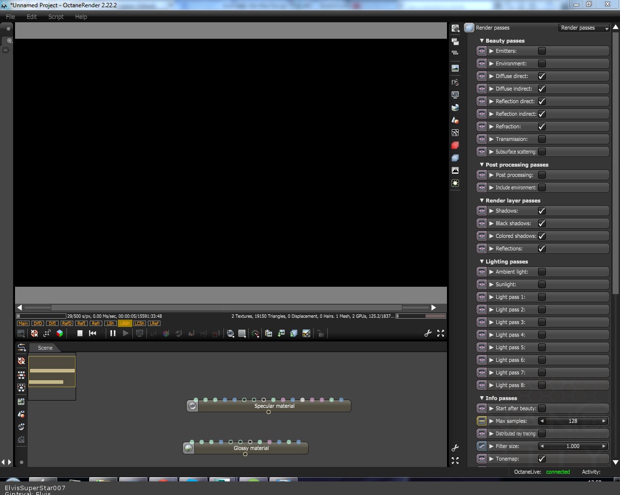

Hello! I have some problems with render AOVs. Is it possible to achieve clean diffuse render layer without shadows and caustic? Also there is some problem with reflection layers. Probably reflection layer catch some diffuse component or albedo. With great regards Elvis
reflection direct not work
shadows also do not work

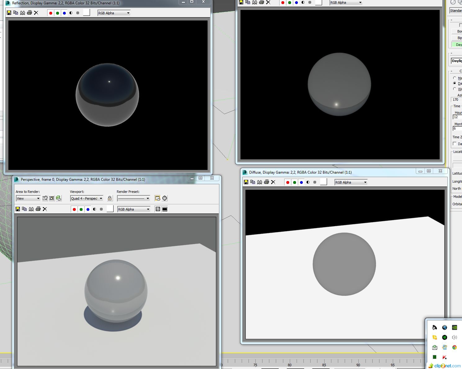

mentalray
reflect
refract
diffuse
beauty
							reflect
refract
diffuse
beauty
