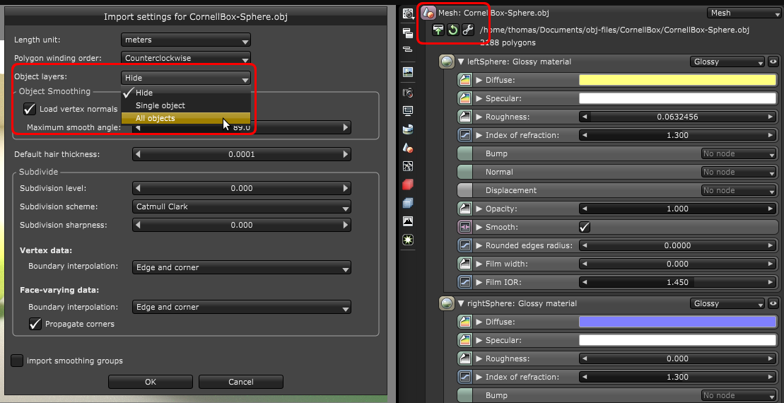

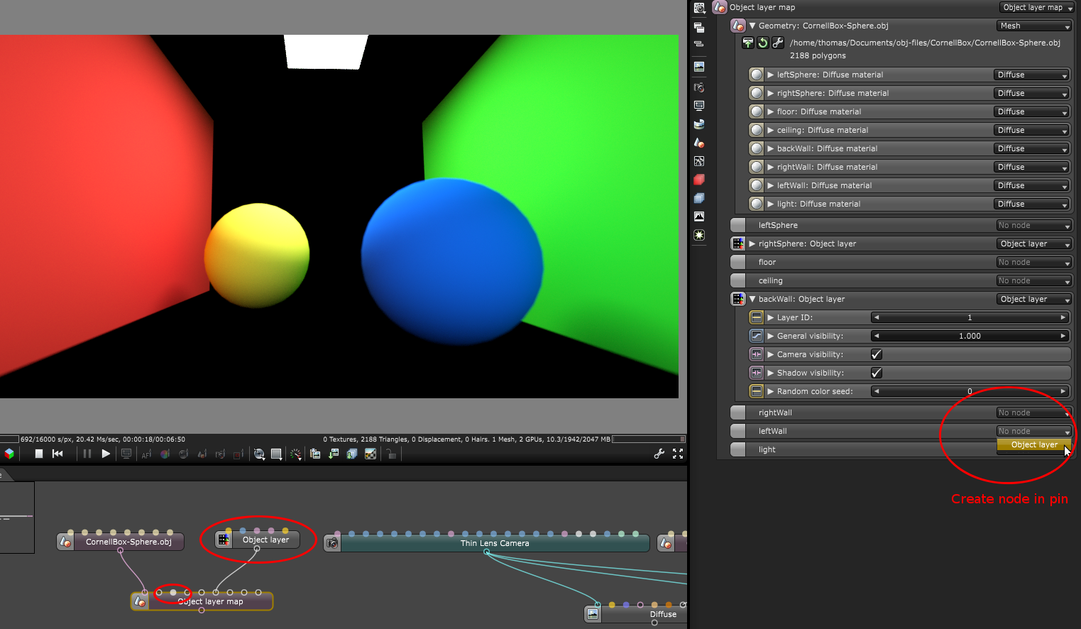

Hi,linvanchene wrote:Maybe I am having three different challenges here. At least two seem somehow related.
Question 1:
Can someone provide more information or a screenshot?abstrax wrote: [*] Added new import option to the mesh node, which allows you to create object layer pins directly on the node, without having to use an additional object layer map node.
WHERE exactly can I find that import option and HOW can I create object layer pins directly on the mesh node?
Question 2:
I noticed when I export an .ocs scene from a plugin then there is only a pink object layer map node.
But the pink object layer map node has allready all options like shadow, camera and general visibility.
Nevertheless when I want to create a scene from scratch in OctaneRender standalone I still have to add a grey "Object Layer" node to the pink Object Layer map node.
Without the Object Layer node the Object Layer map node does not show shadow, camera and general visibility.
How can I make the shadow, camera and general visibility options appear on an a pink Object Layer map node WITHOUT adding a grey Object Layer node?
Or is that something that can only happen automatically when exporting .ocs scene files from plugins?
Question 3:
WHY is there a need for a different pink Object Layer Map and a gray Object Layer node anyway?
Just to be clear I am not suggesting to change that again now.
I am more interested about understanding the underlying logic behind this.
There may be some rules about node types that I did not yet realize.
You can configure object layer pins via the import settings. Click on the wrench icon of the mesh node in the node inspector and then select the desired option in the
Object layers combo box. This will create new pins on your mesh node (A necessary condition is that the obj files is exported with groups. If not, Octane can't separate distinct objects). Like this:I don't think I understand your second question, but I'll try to answer anyway. I guess you are confused by nodes and nodes in a pin. There's absolutely no difference between them. You create external node via the right-click popup menu in the graph editor and you can create nodes in pins via the node inspector. How the plugin creates the node configuration is up to the plugin developer. We notice that more users are working with a hybrid approach these day where they use plugins to set up a project but tweak it later in the standalone so plugin devs are taking more care of setting up nice node setups.
Nothing special about the object layer map. It's only a way couple a mesh with it's object configuration.
Hope this helps.
cheers,
Thomas
- linvanchene
- Posts: 783
- Joined: Mon Mar 25, 2013 10:58 pm
- Location: Switzerland
Thank you so much, two more things learned about Standalone today.
For some reason up to this day I did not consciously think to click on the "No node" pull down menu.
Update/Edit:
The reason may be that I interpreted the grayed out "No node" message as "you cannot interact with this option in the current state" because in some other software I use grayed out options behave this way.
Glad that I know now alternate ways to do this.
Thank you once again!
I may have clicked on the wrench icon in the past but did not remember to see that option there.stratified wrote: Hi,
You can configure object layer pins via the import settings. Click on the wrench icon of the mesh node in the node inspector and then select the desired option in theObject layerscombo box. This will create new pins on your mesh node (A necessary condition is that the obj files is exported with groups. If not, Octane can't separate distinct objects).
Spot on! Whenever I saw grayed out "No node" I would have right clicked in the NGE window in the past and looked for the proper matching node and then connected it.stratified wrote:

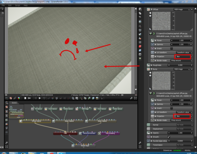

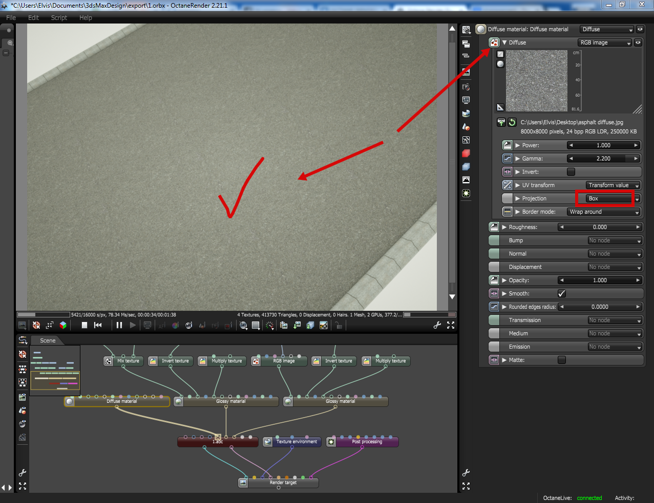

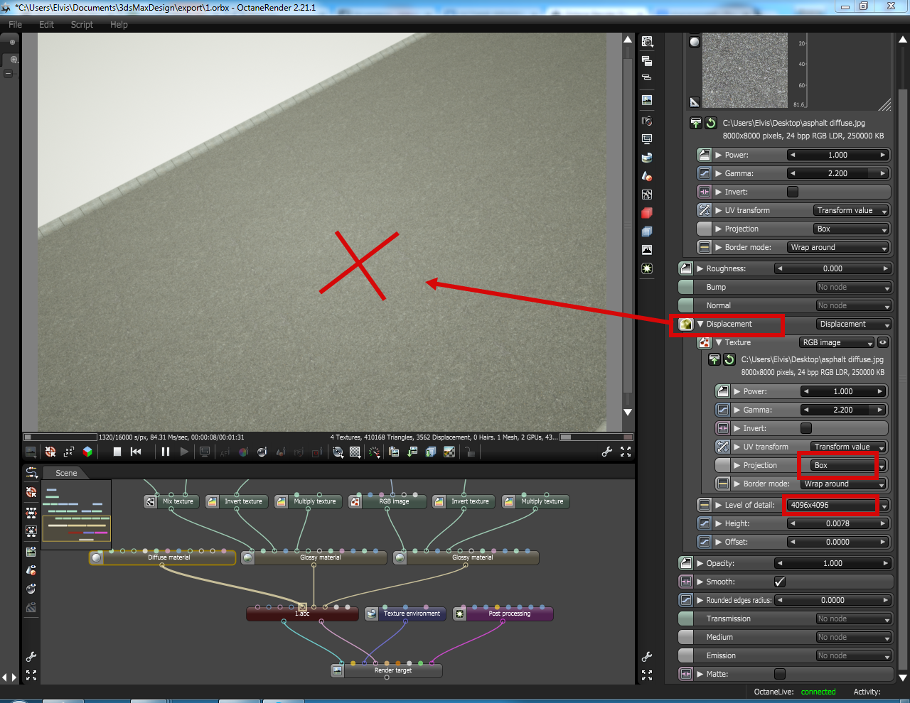

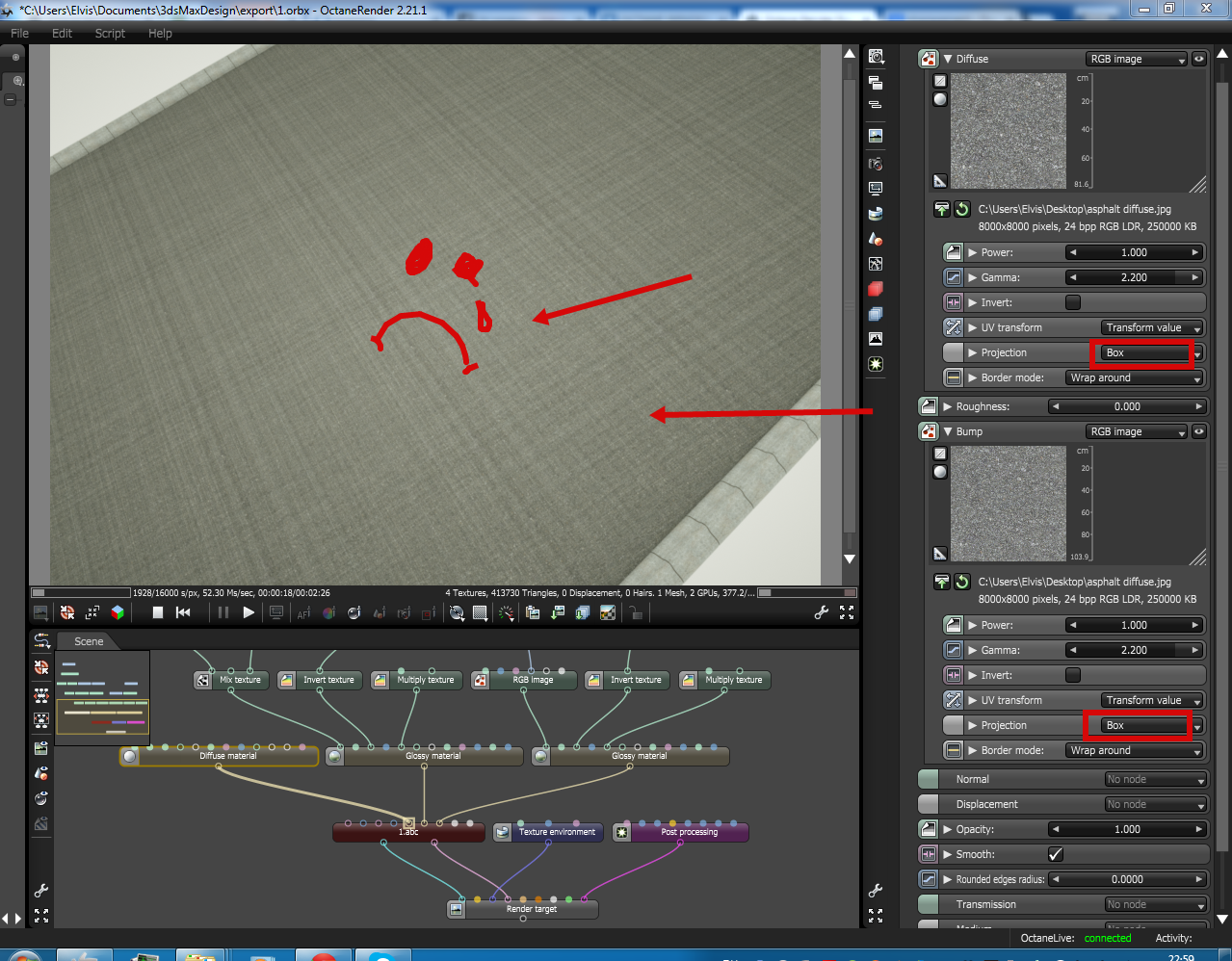

- Elvissuperstar007
- Posts: 2619
- Location: Ukraine
- Contact:
projection does not work in the bump and displacement
Standalone 2.21.1
Standalone 2.21.1
Displacement mapping supports only UV projection. Bump mapping supports all projections. Could you send us / post the scene with the incorrect projection of the bump map? Thanks.Elvissuperstar007 wrote:projection does not work in the bump and displacement
