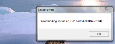

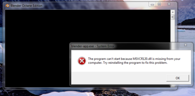

Here is what I am getting..
2
2
1
1

Can confirm the socket error. It is so annoying when octane just doesn't want to render anymore

@orion_uk,
As far as the missing .dlls, you can go here https://www.microsoft.com/en-us/downloa ... x?id=40784
I usually include them with my builds so their plug -n- play, but the link above will provide the same :)

Sockets — turn off all Octane processes (make sure that they're not running via Task Manager).
DLLs — Just copy from Official Blender Trunk.

00Ghz, tungerz & aLeXXtoR, Many thanks ;)
I will try this later this afternoon :)
