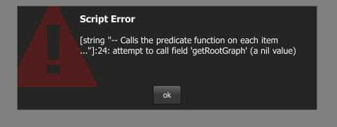

There is something different in Lua that make the script "refresh scatter nodes" not work anymore, giving this error message.

stratified
Posts: 945
Joined: Wed Aug 15, 2012 6:32 am
octane.nodegraph.getRootGraph() changed to octane.project.getSceneGraph() a couple releases back.
