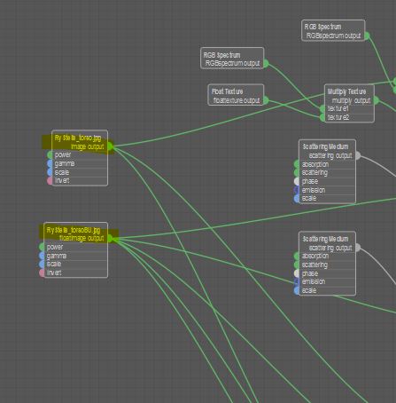

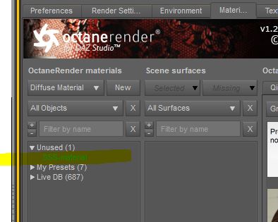

I am not sure if this will work, but I saved the SSS Shader I used above in a DUF File.
Unzip the DUF File
Load the DUF file after opening DAZ
You should see one unused material in your material list.
There are two nodes in the Shader that will need to be edited. The top is the diffuse Texture, the bottom is the bump texture. If you want you can also activate templating on those two nodes

Thanks. Loading the .duf works perfectly

BTW, the material I uploaded can be easuily customized to fit your skin type. There is a Multiply node in the diffuse channel that regulates the skin tone. By adjusting that node you can change the overall skin tone
In regards to the lag. Yes, I have found that this happens sometimes when I apply a material to a surface. However the lag should disapear one the material is applied to the first surface.
