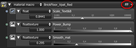

To sort out the macro node issues reported here a few times, Roeland merged some changes from the development branch into the stable branch. Now you can switch between two display modes for macro nodes:
If the node graph of a macro node contains input nodes (which are displayed as input pins on the node itself) the input pins will be displayed as default. This hides the internal node graph. Using the icon marked above you can switch to the node graph that is connected to the output node, hiding the input pins.
This change plus more stuff was planned for the next release after stable 1.20 and probably will make even more sense then, but hopefully it helps with the current problems, too.

this is great, a big thanks, now the workflow is no more broken and is also easy to work with pins now
thanks again guys for the fast correction, very appreciated
