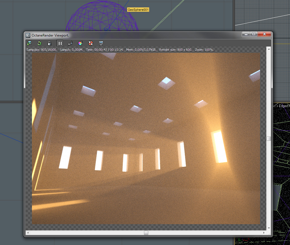

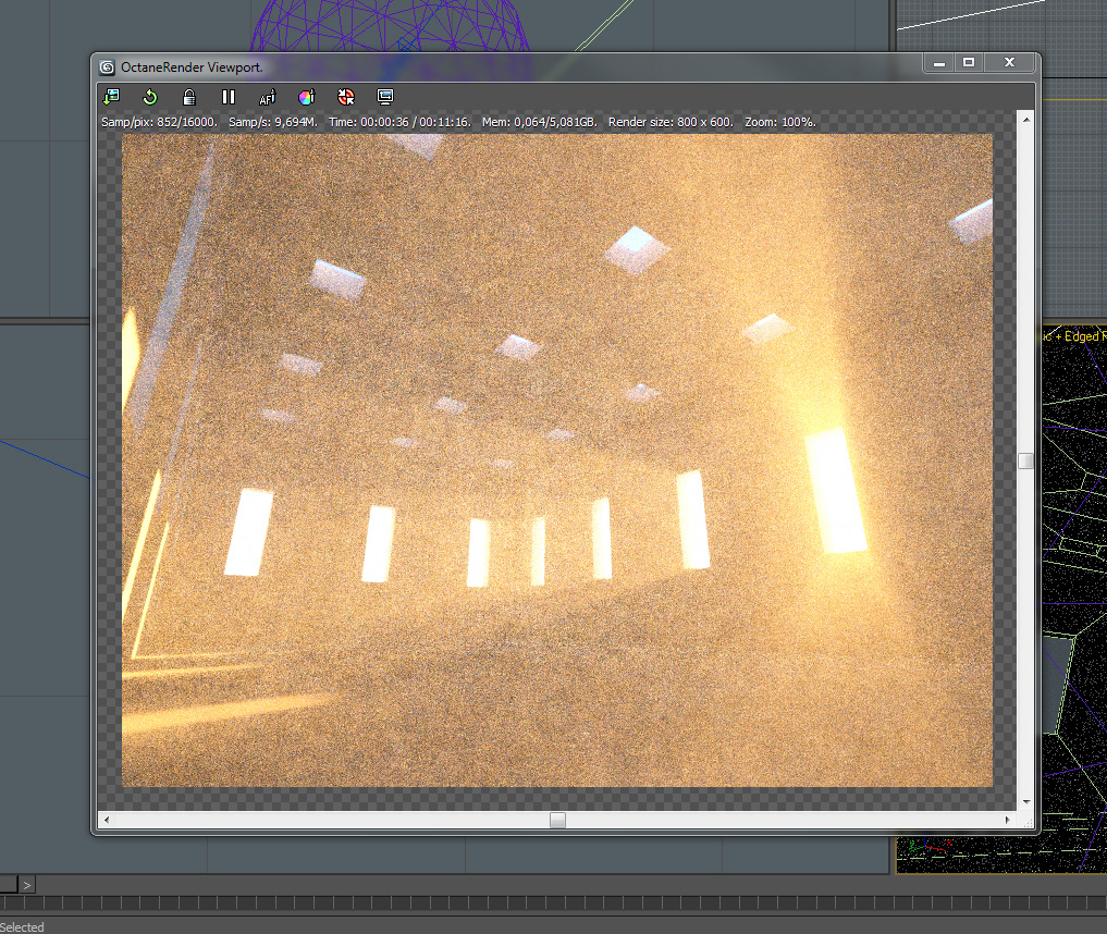

Whats happening with Mr.PMC here?
It is much faster than Pathtracing but gives big blotches which go fullbrigt. I had to reduce scattering to 0.1 and scale to 0.05 to reduce it a bit.
But look is totally different as PT.
PMC goes mad after 80 samples or so.

mbetke wrote:Whats happening with Mr.PMC here?
Hi Mbetke,
This can be normal for PMC for low samples per pixel, try leaving it to render out some more, at least a couple of thousand spp. Hopefully it will level out to be more similar to PT.

mbetke
Posts: 1298
Location: Germany
No it just gets brighter and brighter. No changes and very unusual if I compare with other PMC renderings. I had this bright blotches phenomenon last time if I use too bright HDR images.

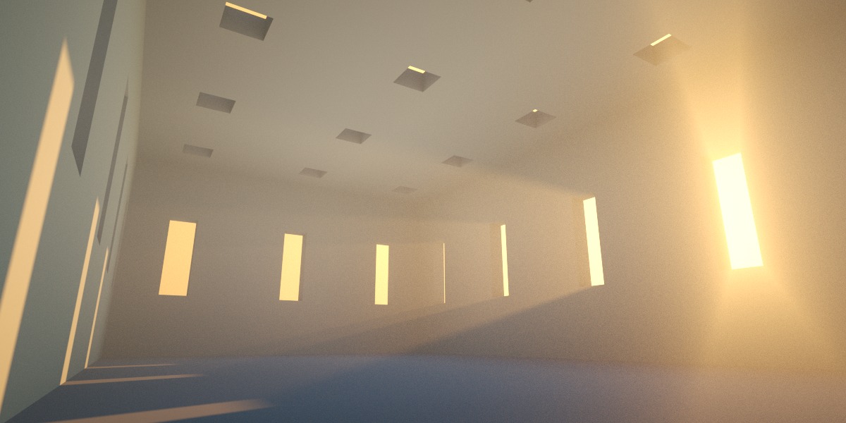

Karba wrote:
JuM wrote:However it can not be used in big scenes.
Really?
What about that?
Fantastic!!! thats what i mean exactly:D
Karba could you please share the settings? or max file!!!
