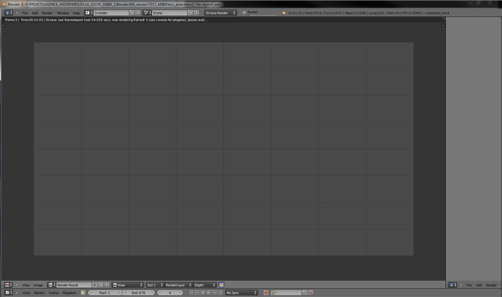

=> I can render still images perfectly now, BUT when I export an animation it renders the 1st 2nd and 3rd images, but just after rendering the 3rd one, Blender simply freezes. Even if I move to frame 125 for example, it will only render the first 3 images, and then freeze.
I let it run like that for hours but it just won't launch the next images' renders and here's the screenshot below...
I get no error message, no pop-up window or anything. Just frozen... I have to force Blender to close by clicking twice on the top-right red-cross...

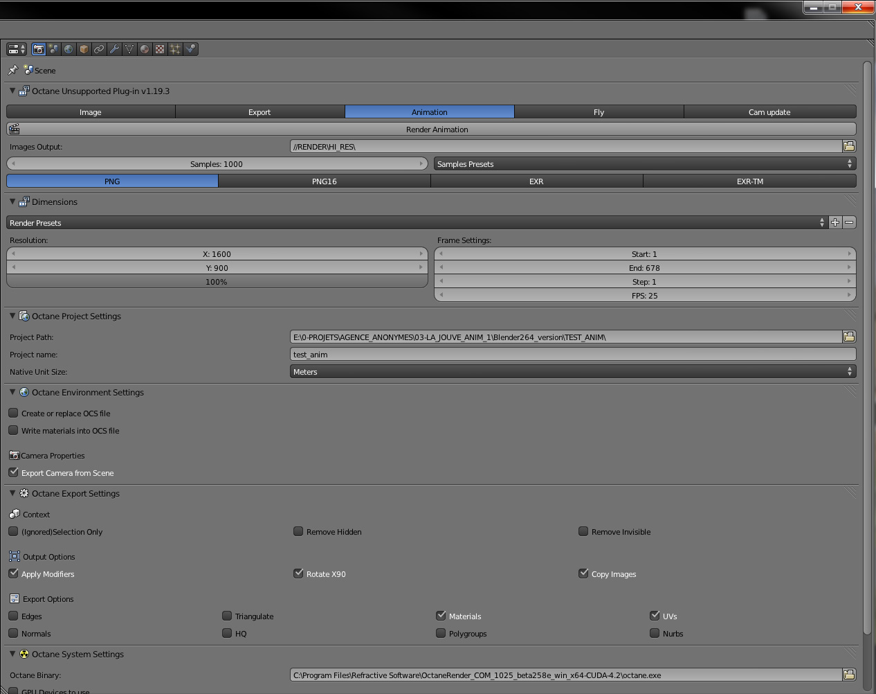

Your image destination folder is not a full path, could that be causing your issue, it's the relative path rather than full path.

@ DayVids => Thanks. I entered the absolute path in the "output" field but it doesn't seem to be at the origin of the problem. Still crashes...
