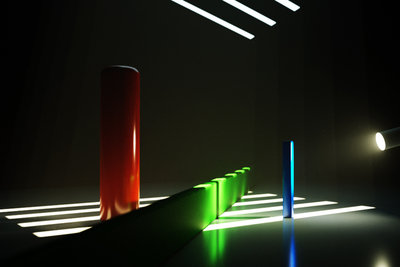

i meanwhile googled for "frustrum box" and already got it (pat myself on the back)
... combined with kubos sinrays method: btw, seems to be the first time, that fireflys did add a little realism

Hi all,
Nice test ! If you want, this material and a little note are include in the Live_DB. You can connect a turbulent texture in scattering for non-homogenus participating media (already inside the material).
Enjoy,
Matt
PS : With direct lighting, you will have faster result and shadows drop in the volume but volumetric is more burn, and you lose the quite the physic volume appearance. You can use a special setup in direct lighting just to compute the fog.
