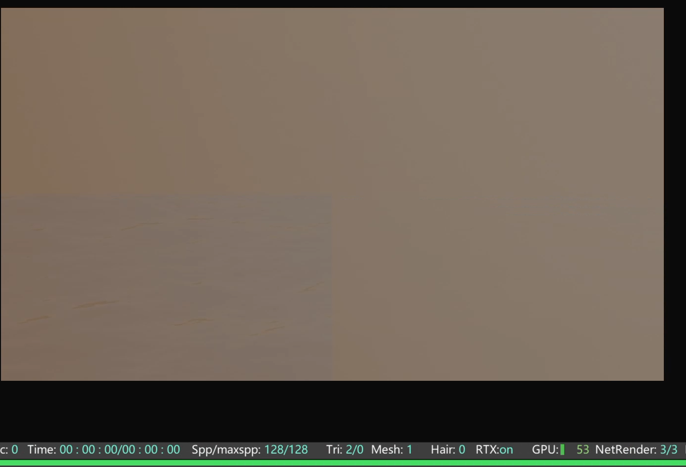

When the viewport is moved, only the local GPU is used for computation, which works fine. After releasing the mouse to start network rendering, you can see the blocks, and each block disappears one by one.you can see from the screen recording that there are no problems when rendering locally, but this problem occurs after enabling network rendering. What's going on?

Confirmed!
I have reported the issue to core devs, it is not a plugin issue, you have the same behavior in Standalone too.
