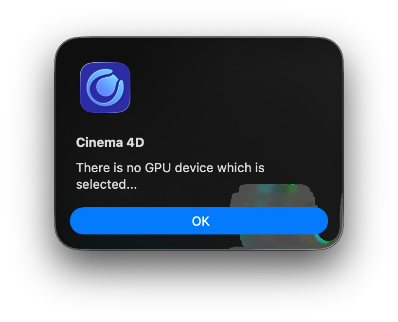

I'm having trouble with Octane and get this error when starting to render. The Cinema 4D scene is empty.

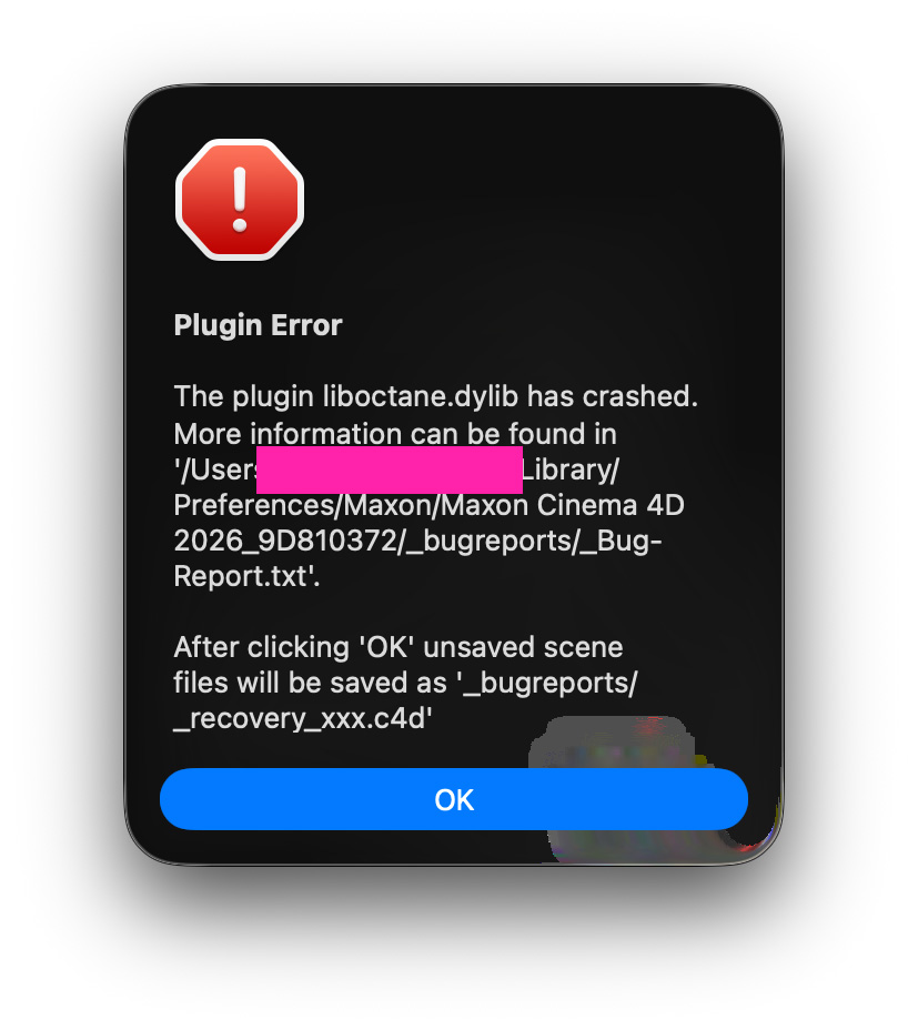

Then I get another error message, and Cinema crashes to the Desktop.

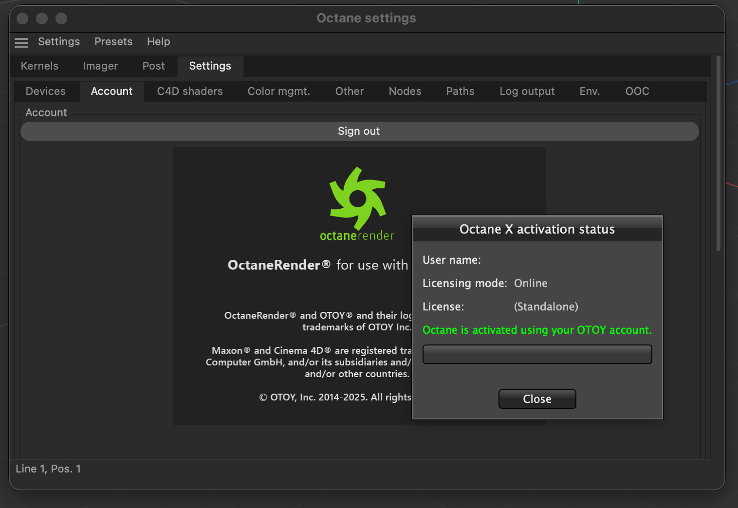

When opening the Octane Settings, the chip is by default unchecked. And if I try to check it, it doesn't change anything, and the critical error remains.
I tried logging the plugin out. But this doesn't work either, as the button is broken and doesn't do anything when pressed.

The issue is macOS 26 Tahoe.
We have just released the first OctaneRender Standalone version 2025.4 supporting new macOS Tahoe:
