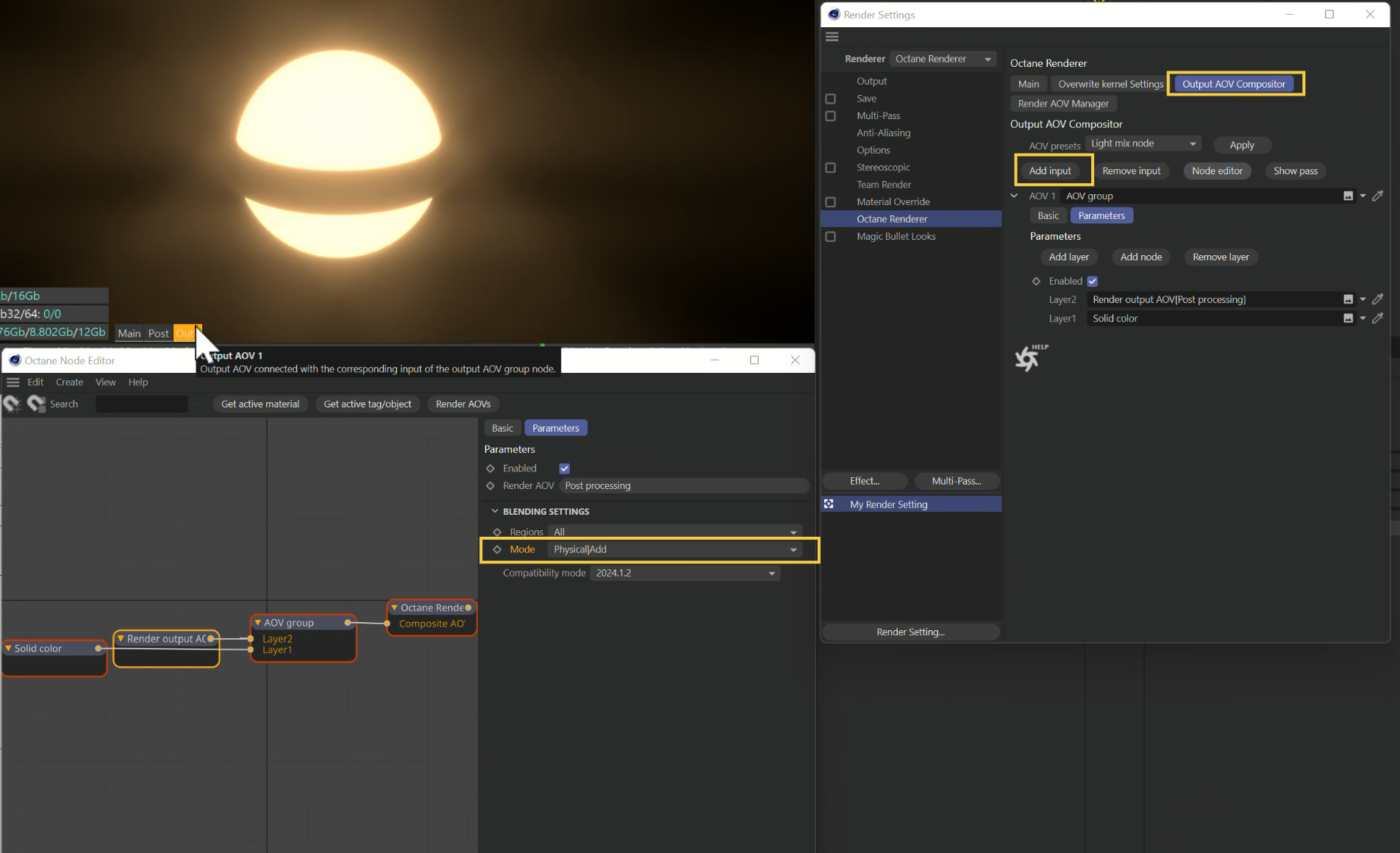

the easy fix is to go to Render Settings/OctaneRender/Output AOV Compositor, press the Add Input button, then create a Solid Color Layer sets to Black, and a Render AOV Layer set to Post effect, with Blending mode sets to Physical|Add:
Then you can use the Out1 AOV in compositor in Linear/Add mode on top of the Alpha Beauty pass.
