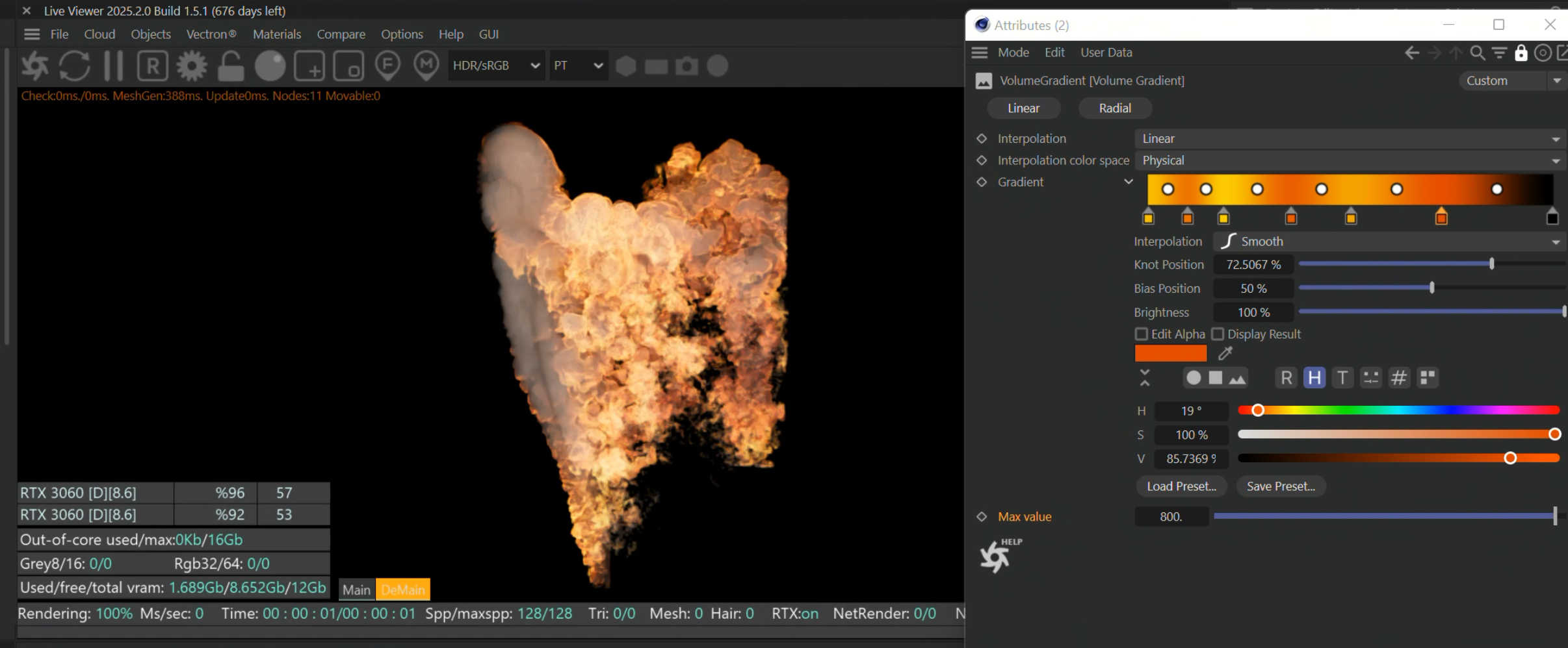

Posted: Fri May 23, 2025 3:27 pm
by Jukyan
Alright,
so see in the picture here ,
whatever how i play with emissive gradient, it affects the tail, the smoke part...
I neet the blowtorch to be like fire, like this :
and its just immossible to get anything near...
what do I get wrong ?!
