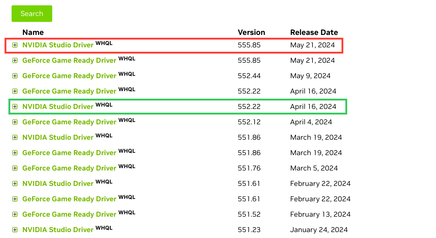

				Several users are reporting stability issues @OTOY Support about latest Studio Nvidia driver 555.85 version and c4doctane.
Performing a clean installation of previous Studio Nvidia driver 552.22 solves the problems.
ciao,
Beppe

				Yes, OctaneRender doesn't need to update the Nvidia Studio driver frequently, but a lot of users have other softwares that need it, like Unreal, for example.
ciao,
Beppe

				Unfortunately, with the 552.22 octane crashed immediately.
EDIT: reinstalled CUDNN manual. Now it works again.

				Unfortunately, Nvidia Studio 560.70 version doesn't solve the stability issue, please stay with 552.22!
ciao,
Beppe
