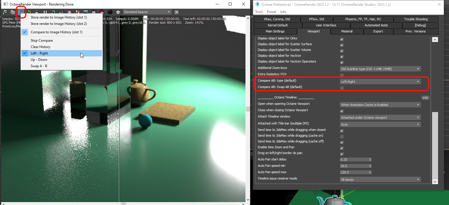

The Octane viewport has a new button (A|B) for the rendered image comparator.
The first time it is clicked, this will store the current rendered image in memory (history slot 1), and start the comparator mode.
This displays both the stored image and the current render side by side.
You can adjust the screen division by sliding the separator line.
When the comparator is active, a click on the 'A|B' button with stop the comparator mode.
For settings and use of more slots, use the context menu on this button.
-Store render to Image History (slot xx)
-Compare to Image History (slot xx)
-Stop Compare
-Clear History
-Left Right
-Up Down
-Swap A B
The 2 options Comparator type (left right / up down) and Swap AB are stored in the max scene file.
The default values (for new scenes and loading old scenes) can be set in the Preferences / Viewport tab.
