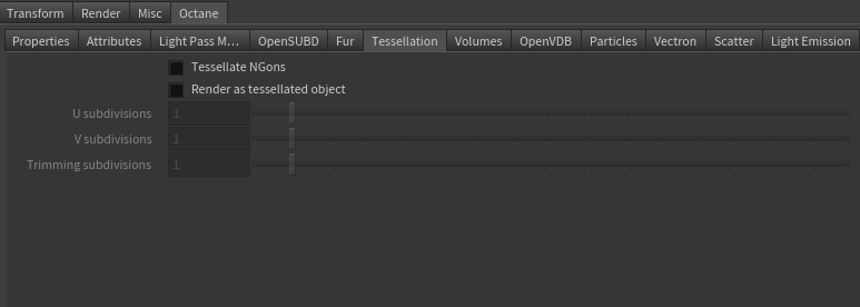

The model has n-gons. You need to tessellate it. Either use Divide node to do that or go to object properties > Octane > Tessellation > Tessellate ngons.
Re: Octane Generating Weird Geo at Render Time?`
Posted: Sat Dec 09, 2023 6:14 am
by RyanJP
Sweet, was hoping it'd be something easy like that, thanks!
