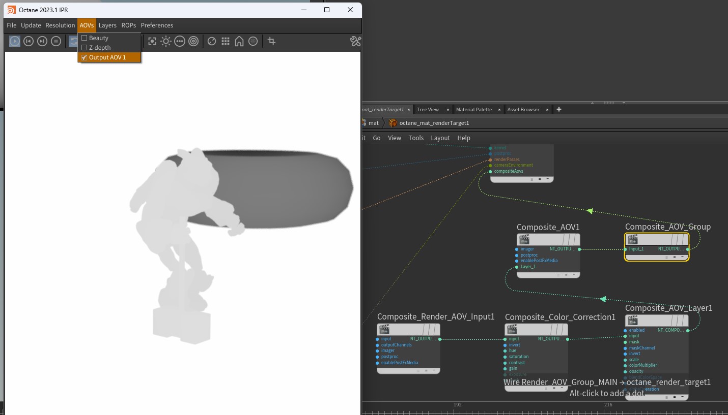

5) Do you just need to invert the AOV? You can use the Composite nodes in the RT and invert with a Color Correction. It will be called Output AOV (See Attached)

It's kinda the same for the Zdepth - if we enable alpha channel, the BG becomes black, obviously. But also the Front is black, so it's kinda useless, or the edges are very jaggy. So the option to make a switch so the front is while would be beneficial.

As for Zdepth, the image I showed is an inverted Zdepth so not exactly clear on what you need there, could you add it to the scene file / screenshot?
