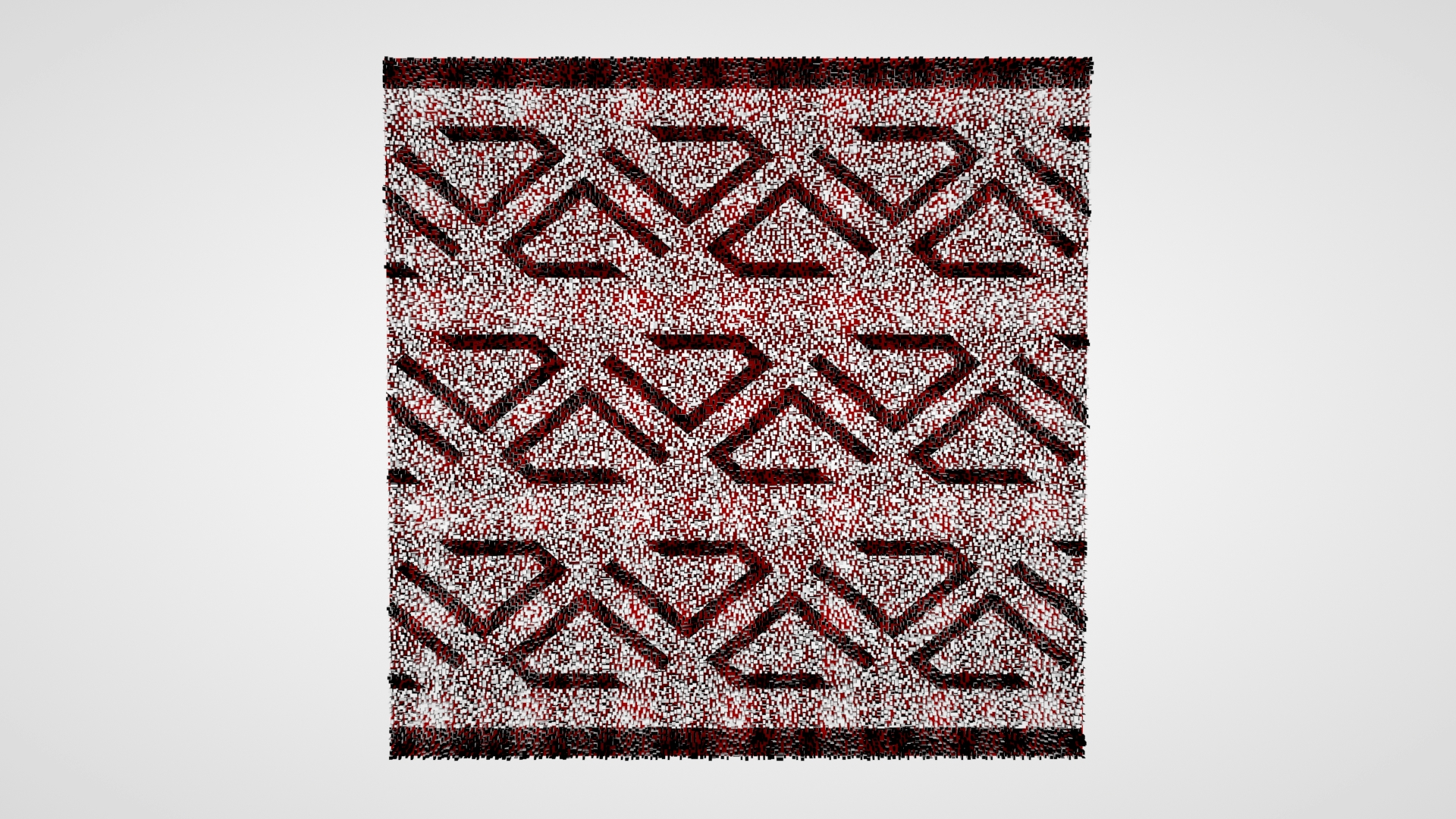

I'm trying to make a carpet using the forest pack pro and forest color, I got many issues on it so I decided to go clean in a empty scene a noticed that the forest color map is mapping any bitmap like a triplanar in next some examples:

And in perspective I get a strange effect of textures crossing each other:
Here the simply material setup:
Is there any suggestion of how to solve this problem? Looking forware to see any solutions to this.
Kind regards...

Hi, I tryed both, forest color and forest material and using 2D custom bitmaps is not working and I'm getting the same results as previously. It's hard to implement Octane to my common workflow, a lot of daily tools used for archviz are not compatible with octane or are half compatible. Things that other render engines adopt at the beginning, Octane fails. To the list:
