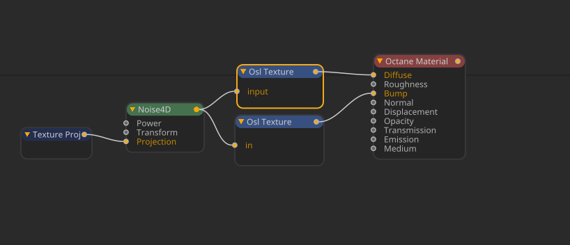

by SSmolak
GausianBlurOSL is the most slowest node.
Also it needs delayed OSL uv projection so the same image can't be used for other channels.
EDIT : but with this attached simple OSL it can be done. It just add plain OSL UV coordinates to texture without changing it so it can be used with delayed UV Projection. So now other channels will not be affected by OSL blur node :
