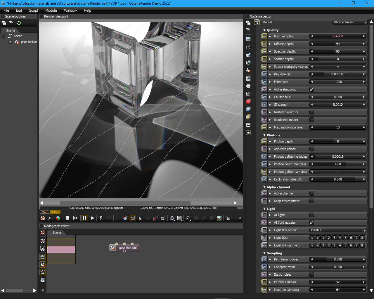

I deceive you - I'm very sorry for the lack of the image rendered at Photon Tracing. lol ;)
PT settings:
Photon Tracing settings - see OP
