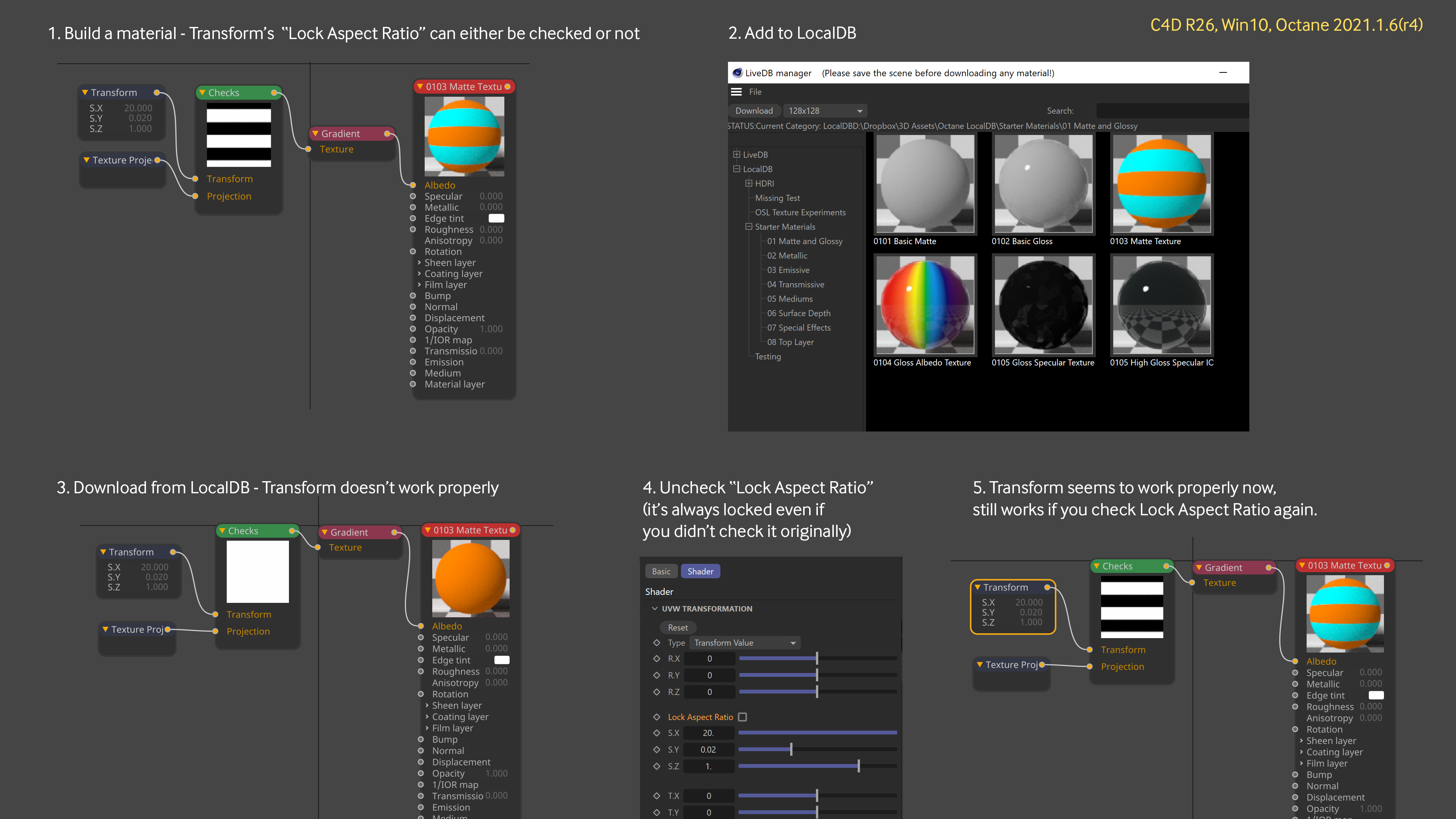

Uncovered another issue related to this.
If there's a Transform Node in the network with custom values, it stops working when the material is downloaded from the LocalDB.
Steps:
1. Build a material, put in a Transform node, set the values. Lock Aspect Ratio can be either on or off.
2. Upload the material to the LocalDB
3. Download the material from the LocalDB
4. Transform node no longer works correctly (see attached)
5. Uncheck "Lock Aspect Ratio"
6. Transform node works properly now.
Visual workflow and c4d test file attached showing the issue.
Octane C4D 2021.1.6(R4), C4D R26, Win10
Transform Lock Aspect Ratio LocalDB Issue.zip
(96.82 KiB) Downloaded 179 times

Did a little more investigation this morning into the Transform node.
It looks like what's happening is that when the material is pulled down from the LocalDB, it's doing a uniform scale based on S.X regardless of what the S.Y and S.Z values are set to.
See attached file created in C4D R26.015, OctaneC4D 2021.1.6-(r4), Win10.
Methodology:
Tried various X and Y Non-uniform transforms on a variety of nodes (ImageTexture, Checks, Octane Noise, Sinewave, Marble). This affected all of them (Sinewave didn't matter since it only scales on one dimension anyway).
Set up Checks node where X was scaled to 1, 0.1, 0.01, 10, and Y was scaled at various values. Posted all to LocalDB. When retrieved from the LocalDB, they all appeared to uniformly scale using the X value.
