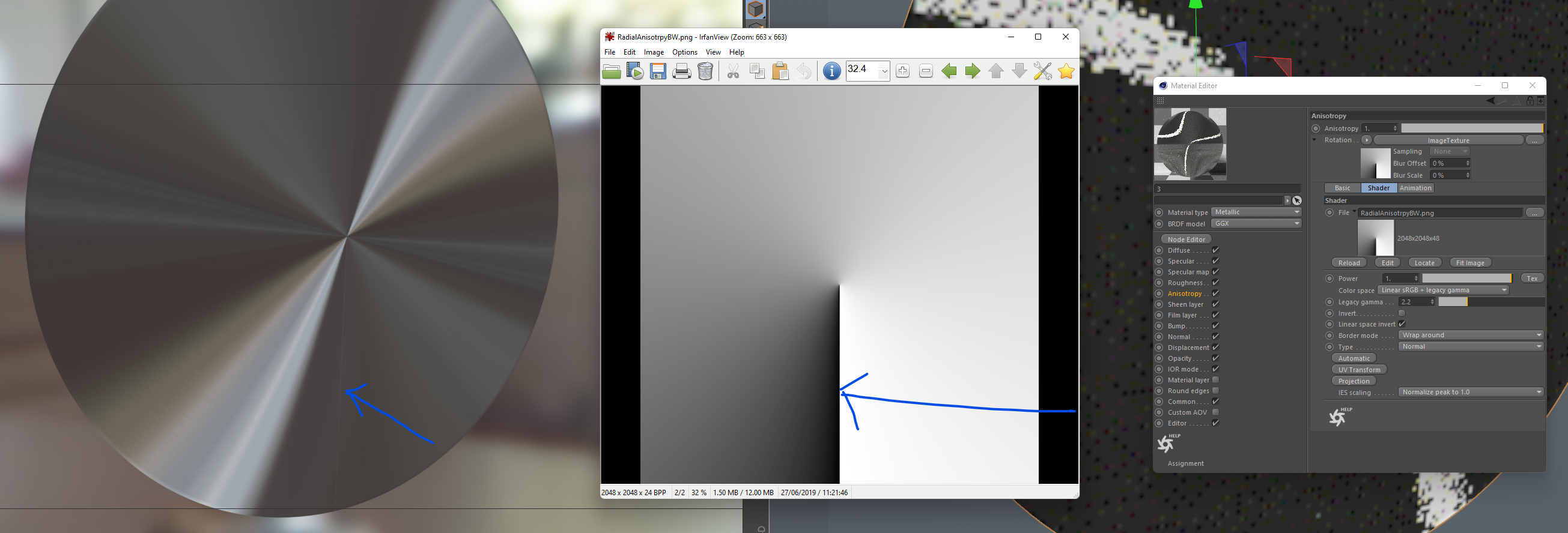

In the attached scene I have a swirled, radial, anisotropic reflection on a round label. It works 99% perfectly, but where my rotation texture flips back from black to white at the 6 o'clock position, you can always see a line in the reflection. Does anyone have a suggestion on how to avoid this?

How about using a procedural version of this angular gradient? This way whatever location is sampled it should always resolve to one side or the other, instead of interpolating between the two as it's doing here.

That should be the solution in theory, but in practice it doesnt work due to the srgb/linear interpolation of c4d's gradient. Left is the pixel based texture, right is the c4d gradient shader. The incorrect gamma input skews the anisotropy off into a curve. Gamma adjustments on a colour correction node cant fix it. Octane doesnt support the different c4d gradient interpolation modes (smooth, linear, cubic etc) so you can't fix it that way either.
