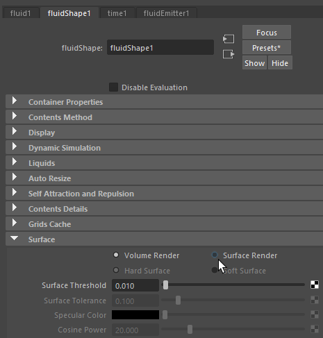

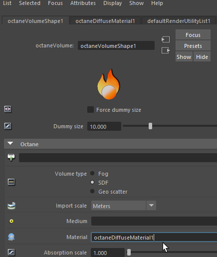

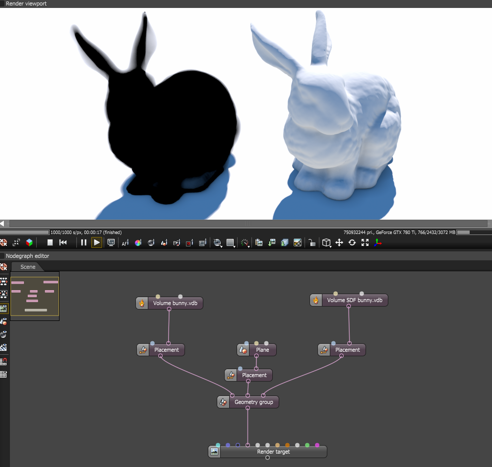

BK wrote:we can not apply Octane materials to Maya fluid since they are volumes.
Hi Bikram,
Maya fluids are not only volumes, they are also surfaces (level sets) :
Indeed this is the exact same thing as Octane Volume_SDF node :
In the plugin Volume_SDF is implemented in the OctaneVolume node:
But sadly this was never implemented for Maya fluids...
