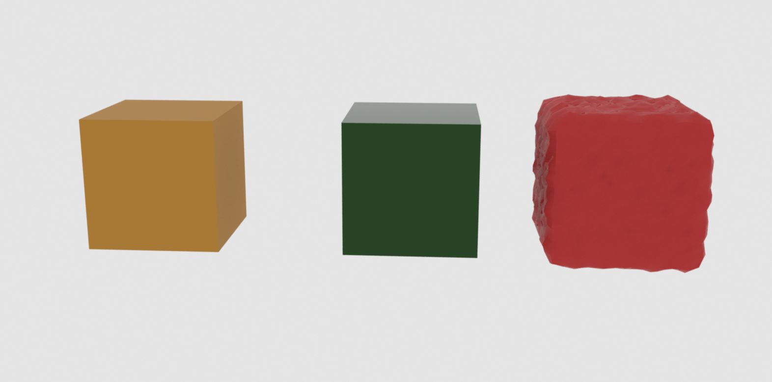

by jobigoud
Can you clarify what you are seeing and what you expect rather than just say "see what happen"? This way it avoids any misunderstanding in case we are not seeing the same thing (due to different versions for example).
What version are you using? (Standalone, Plugin and C4D).
Can you reproduce the problem in standalone?
I get this when enabling the invert node on the yellow object.
Re: Vertex Displacement / OSL
Posted: Thu Oct 28, 2021 11:20 am
by hazenkind
Hy, i use C4D and Plugin. Never used Standalone. Plugin 2020.2.5-R3 Studio Driver 461.72 C4D R25.015
If i enable invert Node, displacement on the yellow cube is gone.
If i now send the Scene and restart new render, displacement on the green cube is also gone without any changes on that green material.
Happens on two different machines with the same Software config. maybe i do a screencapture later if you couldn“t reproduce it.
The red cube is an octane noise for verification that this could be an OSL Problem.
thanks so fare!

Hy,
i tried today the standalone version. After opnening nothing works. the c4d node is now an OSL node. if i change this osl node to c4d noise it will work.
Hmmmm

by hazenkind
OK Guys, i tried a different Computer. And hey, it works.
BUT WHAT COULD CAUSE THIS PROBLEM ON MY MACHINES?
Any kind of Drivers. Do you have any idea?
Posted: Wed Nov 17, 2021 9:09 am
by hazenkind
Hy Guys,
i tried a few things, updating all drivers, cleaning caches, reinstall Cuda, reinstall cudnn etc. But it wont work correct.
Here is a Screencast of the Problem.
2021-11-17 10-00-13.mp4
(9.78 MiB) Downloaded 2169 times
Can you give me a direction what it could be? It seems like a software issue.
regards christian
